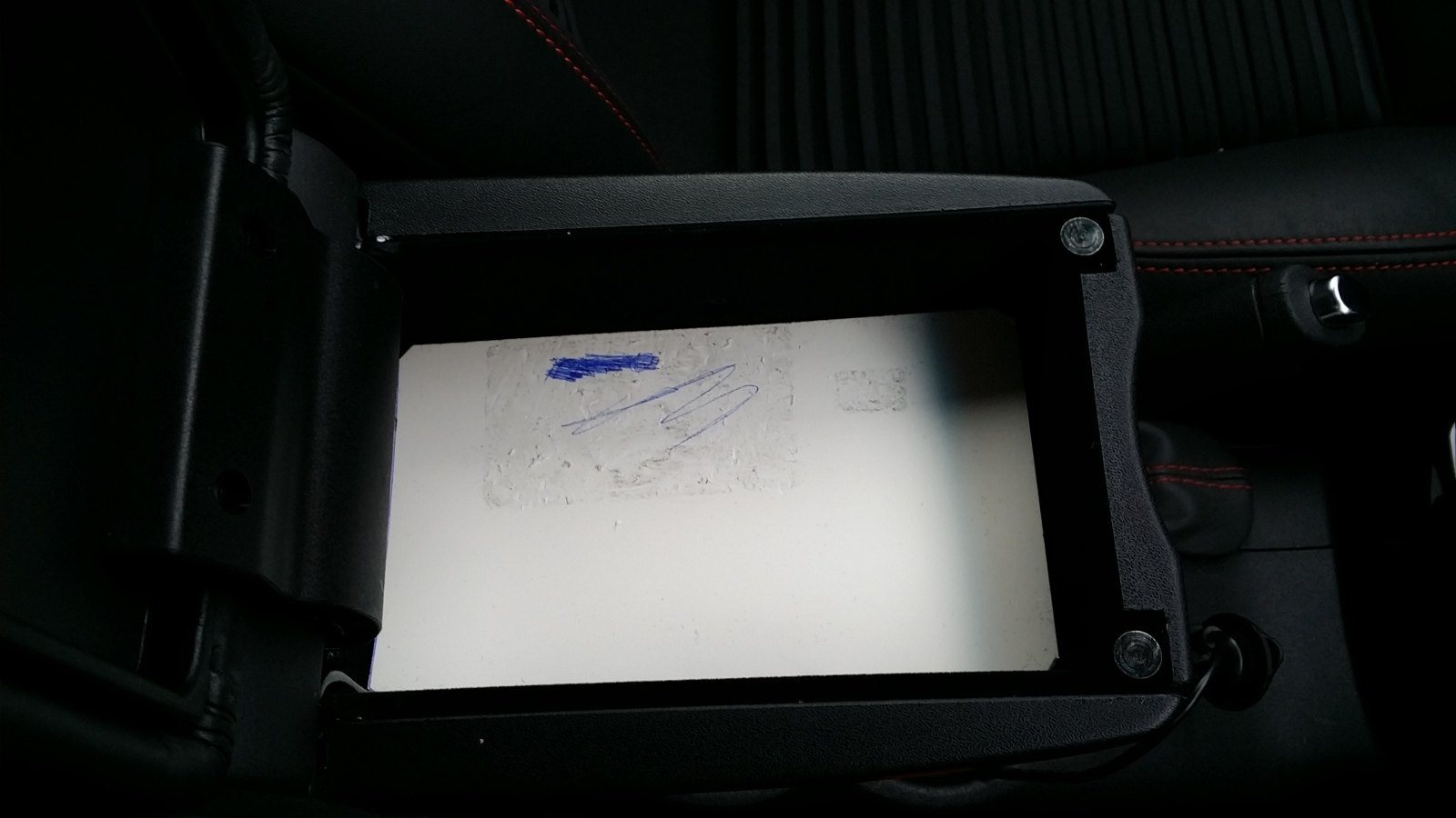

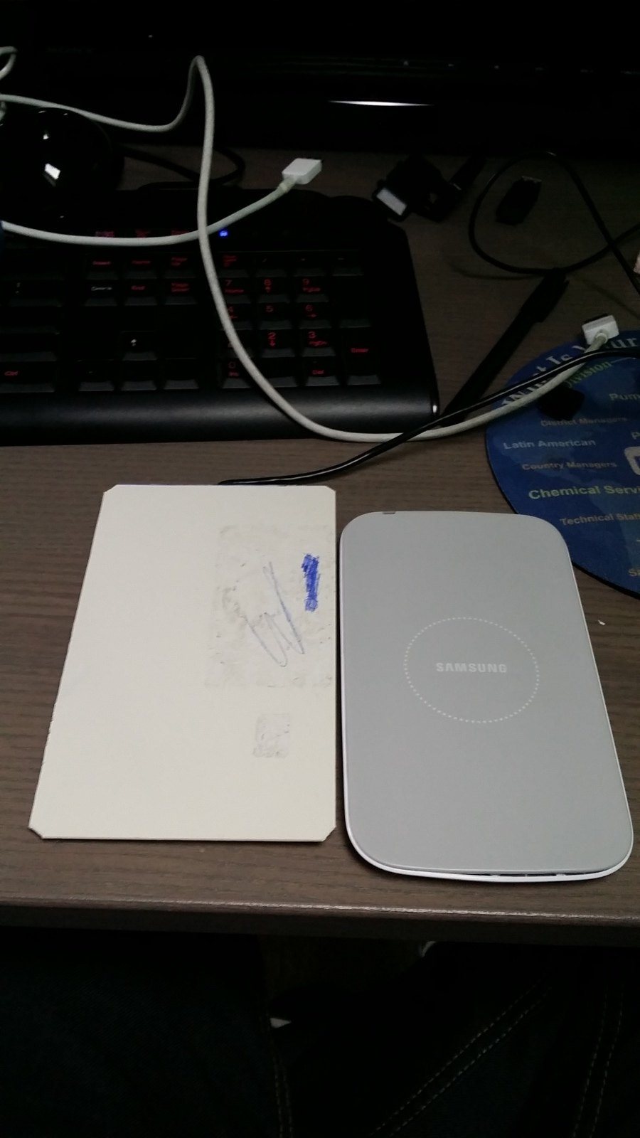

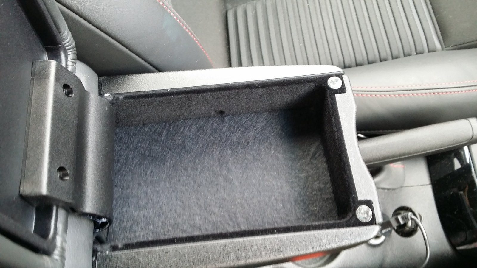

  1. Good day and greetings from the Netherlands.I am here to learn from you guys and to present to you my idea's.Last week i added a smart modification to my Giulietta from 2011.I got an Samsung Galaxy Note 3 with Wireless charging receiver and bought also a transmitter.I dislike having a carholder for a phone in my beautiful Giulietta.So i started thinking about a smart modification. I have a 2din like the My2014 so i thought lets put my phone in the box above on the dashboard.But i always have my sunglasses and papers over there.So i thought lets try something else.(The result): foto [GUIDA] Wireless charging Ricarica Wireless nel porta oggetti - 1 What did i do?I bought a small receiver for the Note 3 (You can probaly find one for your own phone, most phones have one right now. Iphone, Nokia, Samsung etc etc. Just google!)And i bought the Samsung QI wireless charging receiver pad: foto [GUIDA] Wireless charging Ricarica Wireless nel porta oggetti - 2 I had a long micro usb->usb cable wich i stripped and fitted into the kit. The other end goes into a 12V plug with USB female (Later when i found out how to take apart the middle section of the interior i will make everything below the 12V kit with some solderThis whole gadget set works on Induction charging (like electric tooth brushes).I already had this kit with my phone and found out quite fast that the transmitter has the same diameters as the armrest floor.The steps i have taken to complete my beautiful secret of QI wireless charging is as followed:I took apart the Transmitter (the plastic was to thick and took a lot of space!) foto [GUIDA] Wireless charging Ricarica Wireless nel porta oggetti - 3 I had some Styrene (type of plastic) plate still left in my house, it is 2mms thick.I used it to mount the induction kit on it (so it doesnt shift around in the armrest) and to make a top plate to put some adhesive felt on.I also ha foto [GUIDA] Wireless charging Ricarica Wireless nel porta oggetti - 4foto [GUIDA] Wireless charging Ricarica Wireless nel porta oggetti - 5 The difference between the OEM housage and my own foto [GUIDA] Wireless charging Ricarica Wireless nel porta oggetti - 6 Fitting it into the armrest foto [GUIDA] Wireless charging Ricarica Wireless nel porta oggetti - 7 The result! foto [GUIDA] Wireless charging Ricarica Wireless nel porta oggetti - 8 Total costs: 15minuts (fitting it out to the correct size) and around 40 eurosGreetings! (and if someone wants to translate this to Italian, i would be thankfull!)

    Comunque, l'idea di per sè è geniale perchè permette di trasformare il portaoggetti nel bracciolo in un caricabatterie wireless semplicemente modificando il fondo dello stesso.
    Da quello che vedo ha comunque lasciato il cavo di alimentazione esterno e non lo ha integrato nel tunnel centrale, ma penso che un lavoro fatto a regola d'arte il risultato sarebbe davvero funzionale.
    Se poi lo si associa a un autoradio touchscreen con mirror link il tutto si fonde insieme permettendoti di usare il cellulare senza mai staccarlo dalla ricarica e senza avere il problema del filo quando scendi dall'auto
  8. Ottimo, grazie!
  9. Yes i still want the cable to be attached underneath the 12V. But i simply dont know how to take apart the tunnel.
    I think i will ask my dealer to do it.
    If that is fixed you really cant see that there is a modification.
