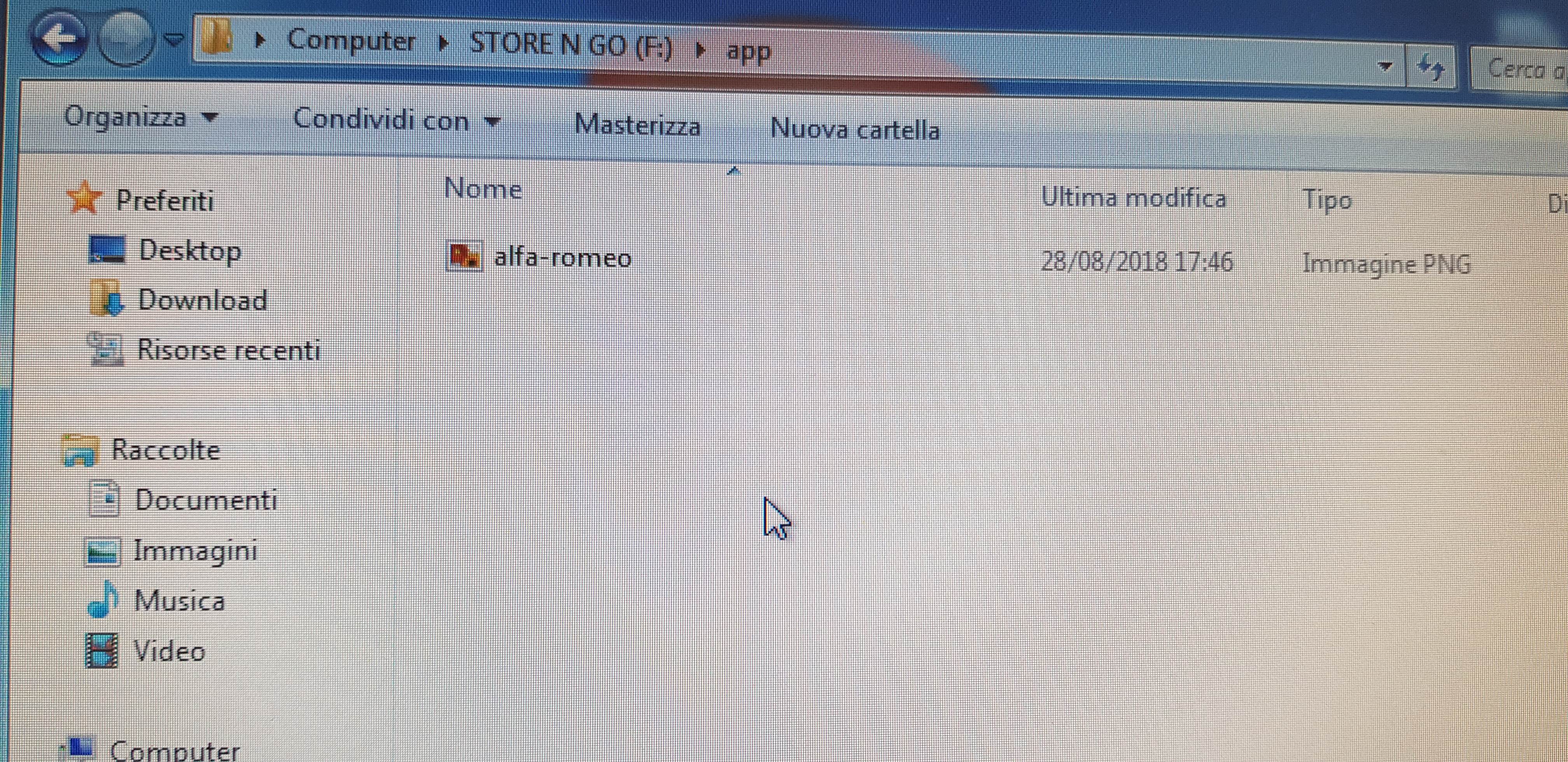

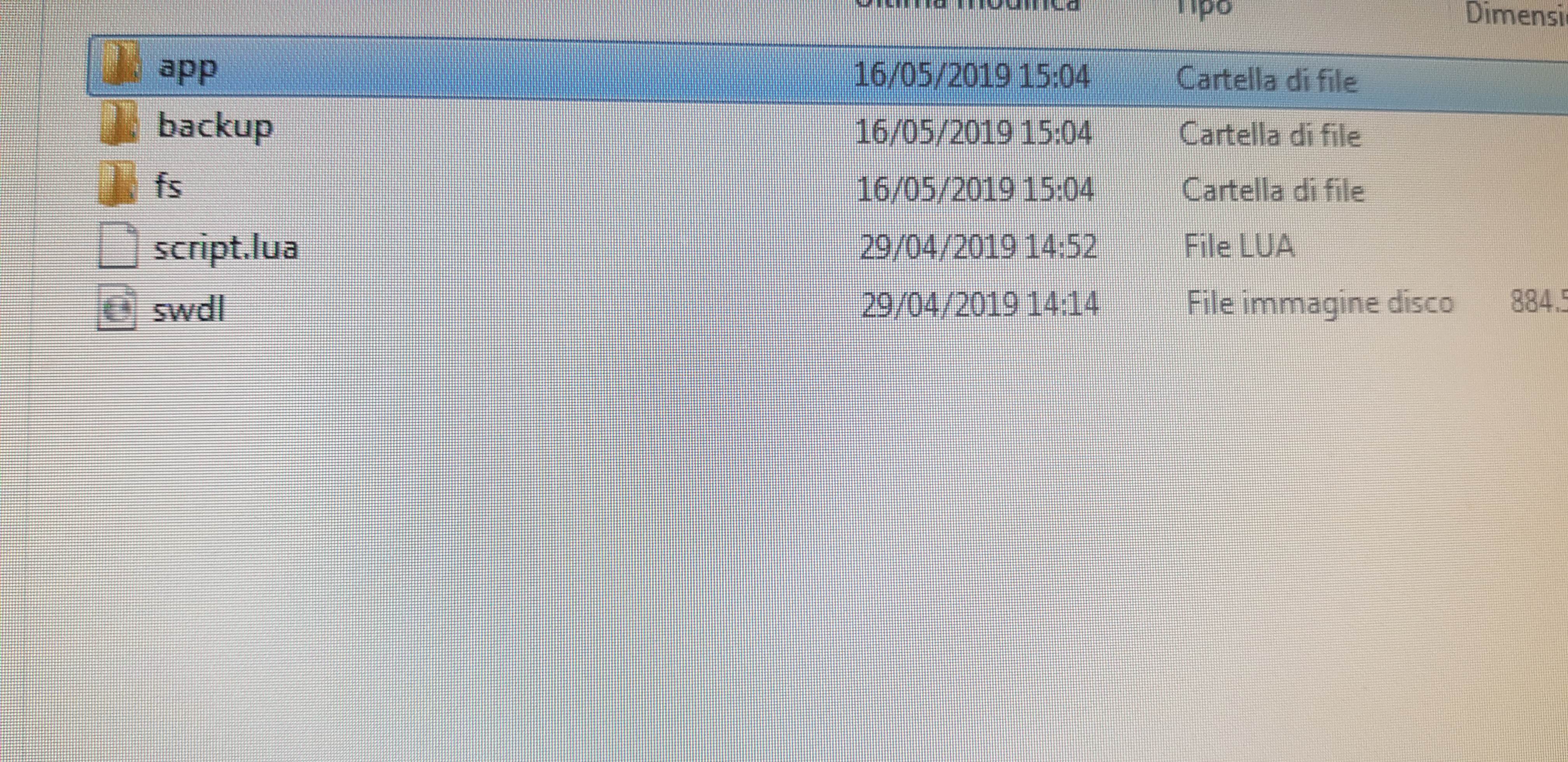

Hi
To change the splash is It right like this?
It told me error!!!
In the backup folder i putted nothing
    1.6 MB · Visualizzazioni: 424
    1.6 MB · Visualizzazioni: 409
