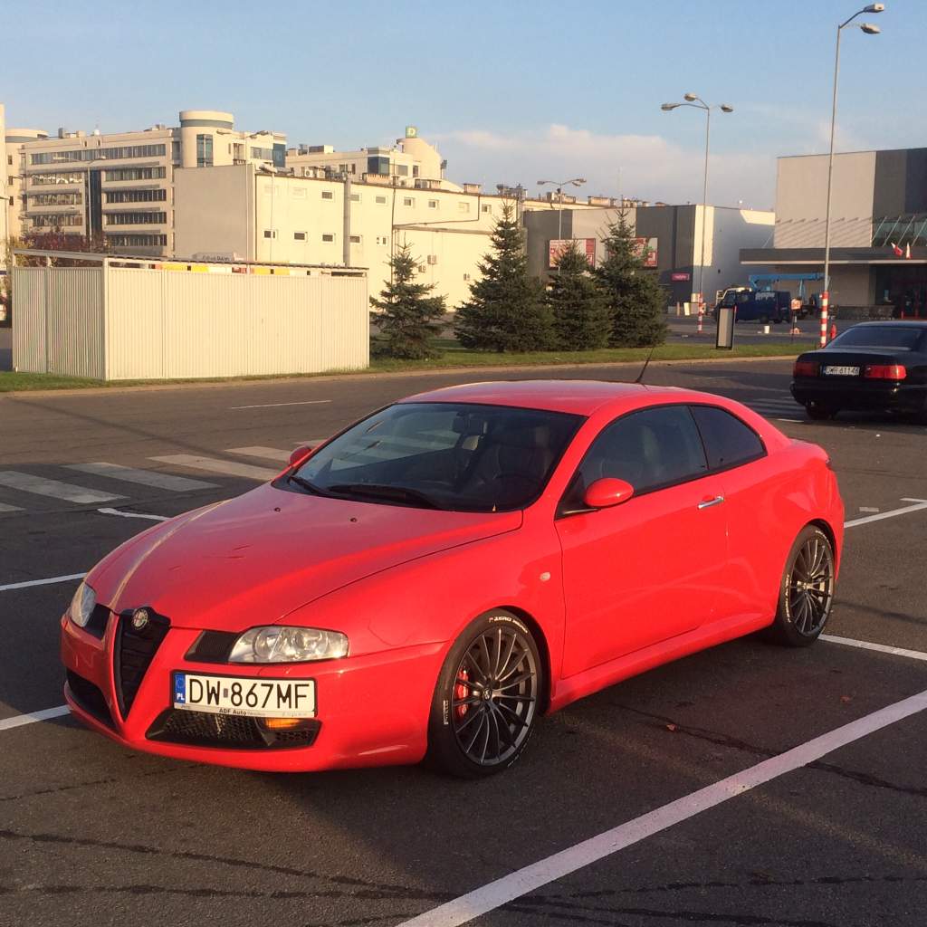

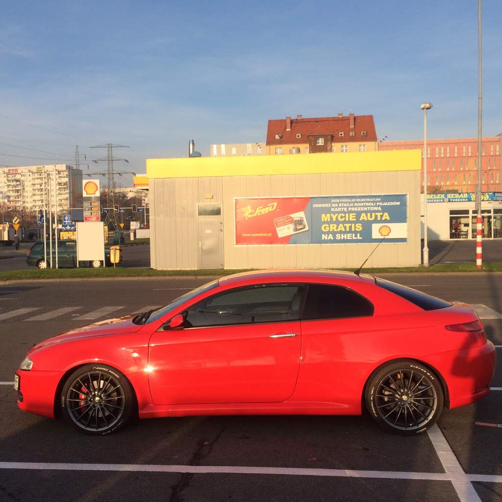

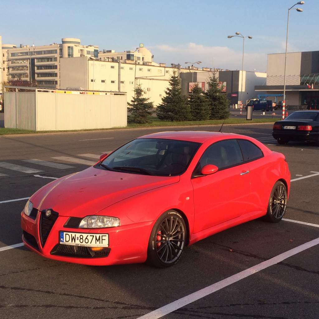

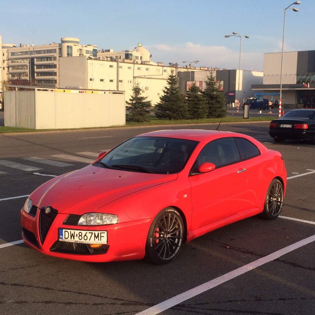

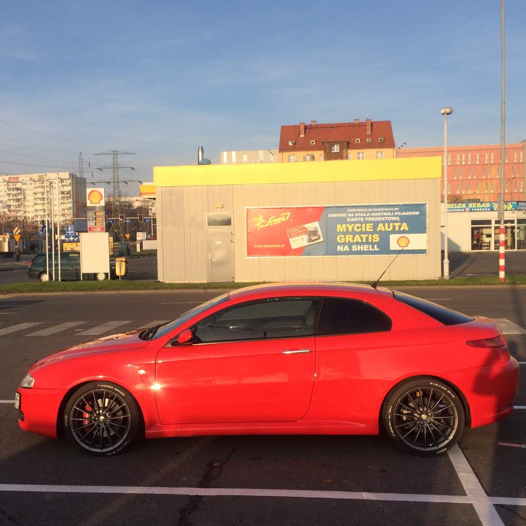

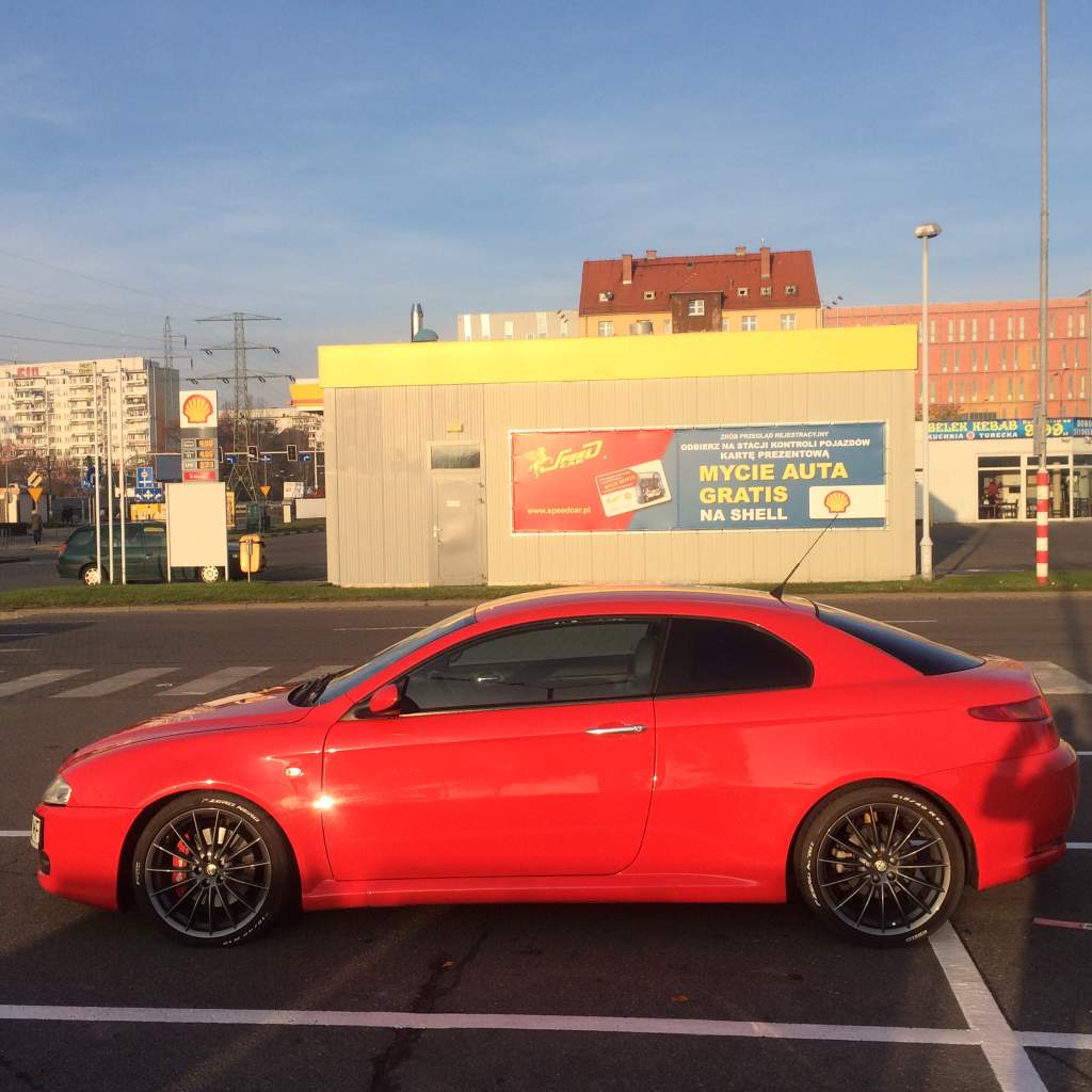

Hello Everyone!
I decided to registry in yours forum because it is the source of my beloved car:)
I have some difficulties with understanding italian so please let me to communicate in english.
Shortly about my car.
Alfa GT 1,9 jtd 2004 distinctive,
I have some mods vs OEM.
I have changed turbo on gtb2260vk
map sensor to 3,5 Bar
Exhaust free flow 2,75" with custom made 4 pipes
Bigger injectors 299
Cut off the MAF sensor
Cone ITG filter
Front intercooler
Stronger clutch and DMF
The result is 243hp/ 496nm 018dc3029130e5148b0e15b93c6d6775784f428699.jpg01484e3fa22f28f9a2f3e527372c2af594006242e9.jpg
I have plan to go over 300hp with some help my italian friends:)
