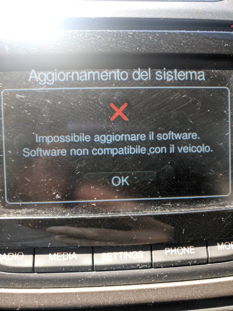

Hello Alfa cousins,
Do not install the update from the 500X.
It will not work, it will either fail or brick your device.
That is an VP2_334 variant and not the VP2_CO variant.
I have asked in the thread for the CO variant. I myself am on a 500L awaiting for the firmware as well. The device should be able to check the configuration.xml and cannot install anything.
Please wait for the VP2_CO variant.
VP2_334 firmware supports FIAT chasis
520/521/334/226 / MP / M1
VP2_CO firmware supports FIAT chasis
250/263/330 / 312E / 312NG / 846/636/637/955/940
Please be careful with what you flash, especially when you are out of warranty.
That is why I separate my firm on the Fiat Forum between the two. They're not compatible with each other!
The firmware is pretty old as well being released 2018-06-05 so I don't expect there to be many changes.
