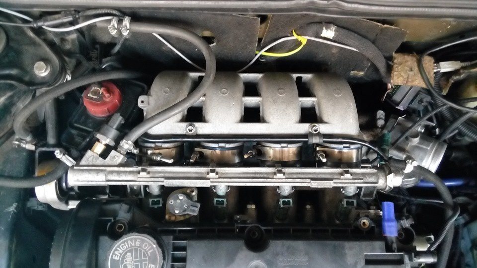

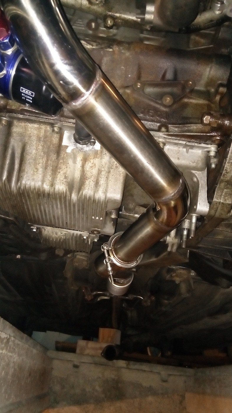

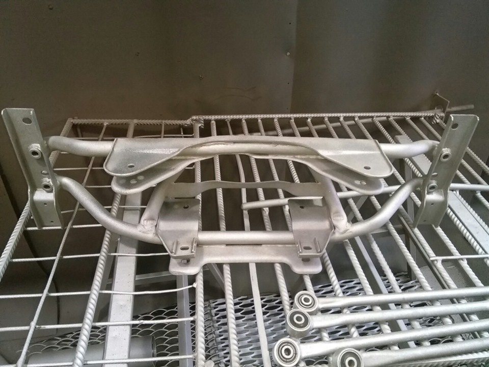

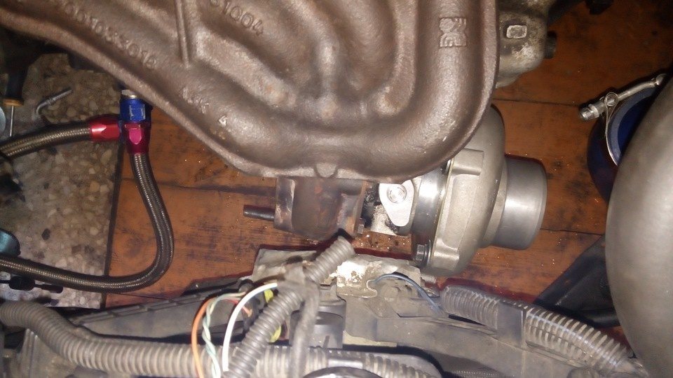

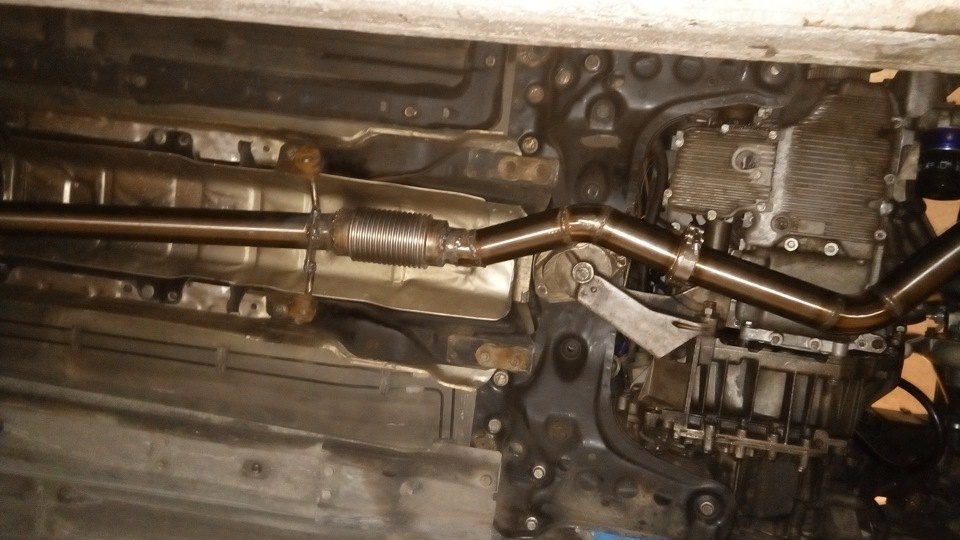

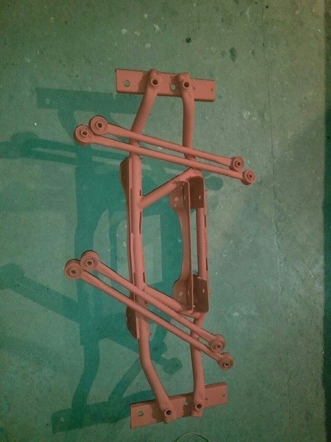

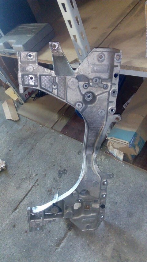

    I from Belarus, and i have AR 159 and AR GT. Now i making custom project with AR GT 2.0 TurboTwinSpark with transmission from Lancia Delta Integrale and AR 156 CrossWagon.
    Specs:
    1) TwinSpark with AR159 TBi exthaust manifold and big Comp Turbo CT3B.
    2) MegaSquirt2 ECU, big injectors, VAG coils and Stock Bosch ECU.
    3) Transmission from Lancia Delta Integrale and AR 156 CrossWagon subframes.
