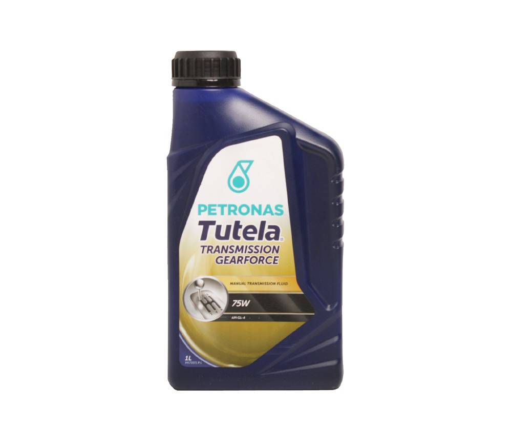

sul manuale porta :Lubrificante sintetico di gradazione SAE 75W. Qualificazione FIAT 9.55550-MZ6 TUTELA TRANSMISSION GEARFORCE Contractual Technical Reference N° F002.F10 C
Sicuro?

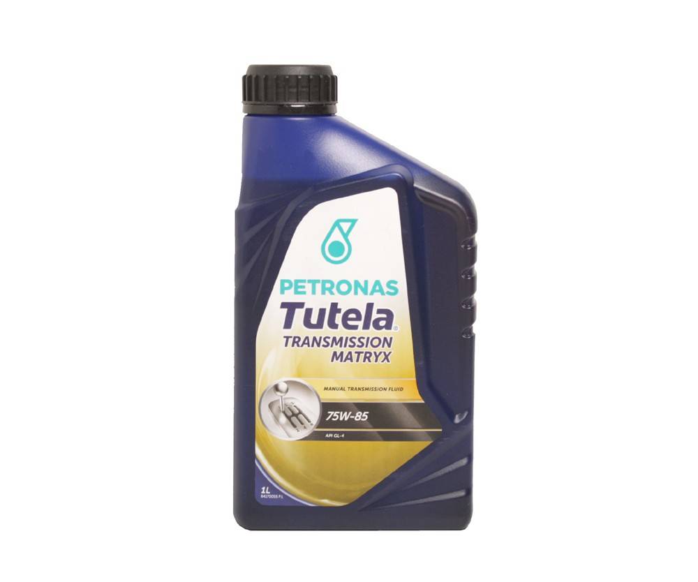

mito 1.3 multijet è prescritto anche questo
Technical data
SAE 75W85, API GL4
Approvals: FIAT 9.55550-MZ1 CONTRACTUAL TECHNICAL REFERENCE N°F108.F02
Alfa Romeo's recommendation for the following cars:
  • 147 GTA
    necessary quantity for one oil service about 2,0 litres
  • 156 2.5 V6 24V and GTA
  • 156 / 166 2.4 JTDM 20V
    necessary quantity for one oil service about 3,1 litres
  • MiTo 1.4 TB 155 bhp, 1.4 TB LPG, 1.3 JTDM (only 90 bhp), various (but not all) 1.6 JTDM
    necessary quantity for one oil service about 1,6 - 2,2 litres
  • 159 / Brera Spider 939 1.8 MPI, 1.8 TBi, 1.9 JTS 16V, 2.2 JTS 16V, 1.9 JTD(M) 8/16V,
    necessary quantity for one oil service about 2,3 litres
  • 159 / Brera Spider 939 2.0 JTDM - only cars with gearbox F40
    Attention there was a second gearbox for the 2.0 JTDM engine for which this oil is not suitable
  • 159 / Brera Spider 939 2.4 JTDM 20V und 3.2 V6 JTS 24V (only manual transmission),
    necessary quantity for one oil service about 2,8 litres
Most of the above mentioned cars will no longer need a regular gearbox oil service if you believe Alfa Romeo's maintanance plan.
The gearbox oil which is filled into the gearbox during the production of the car is considered to be a "lifetime filling".
Nethertheless it is recommended to replace the gearbox oil after about every 80.000 km to remove all the abrasion which accrues during normal use.
Leggi con Attenzione ⚠
Technical data
SAE 75W, API GL4
Approvals: FIAT 9.55550-MZ6 CONTRACTUAL TECHNICAL REFERENCE N°F002.F10
  • all Giulietta gearboxes - manual 6-speed and TCT dual clutch transmission
  • MiTo 0.9 TwinAir, 1.4 8V, 1.4 Multiair (105 bhp), 1.4 Multiair Turbo 135 bhp, 1.4 Multiair QV, various (but not all) 1.6 JTDM
    necessary quantity for one oil service about 2.0 liters
  • 159 / Brera Spider 939 2.0 JTDM - only cars with gearbox C635
