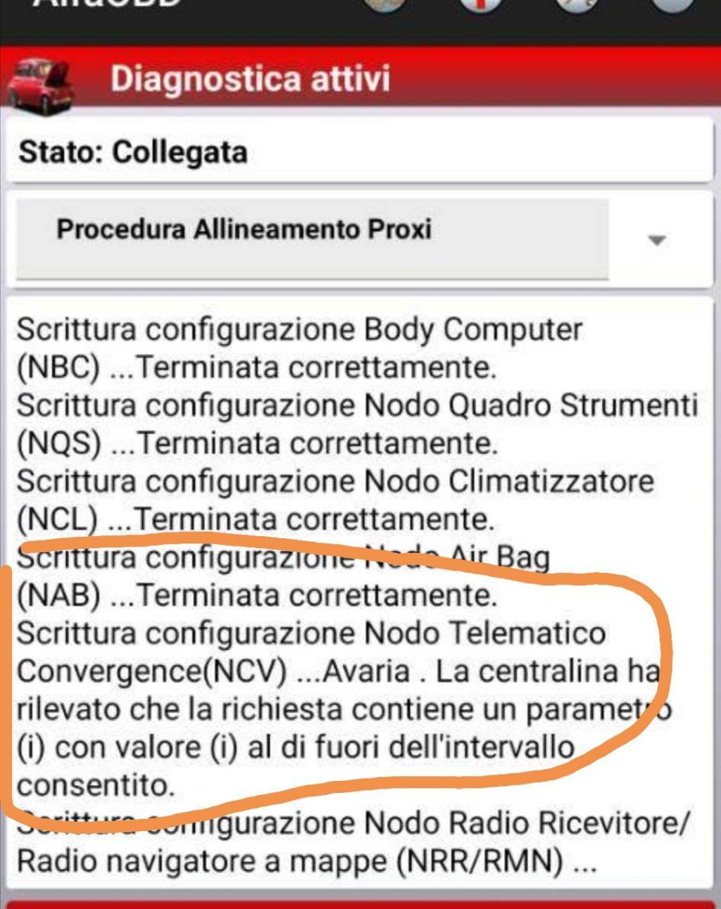

I tried to do the alignment at a workshop but the km continue to flash and the line in does not go yet: I connect the mobile phone with a direct cable and it is not heard.
In addition to the line in cable, do I have to install the usb cable behind the nav or should it work without it?
If I try to align with alfaobd it gives me an error during the alignment regarding a parameter outside the allowed value.
What do you think it refers to, could it be due to the activation of the aux input?

Hello SBU. Were you able to get the sound on pins 7,8,9? Greetings
A guy told me that he creates wiring to mount the original Blutooth interface and mounts everything and one who has hell told me you can open all the doors from the body but he did not hear audio because the chip is missing inside it makes hundreds there is in the forum stu boy is in fact annoyed and makes me do all the tests you want
Also I couldn't get any sound from pin 7,8,9 :)
They told me that even if I activate aux from the body proxy the radio nav that starts for EMG version does not have the aux chip even if I connect to the pins listed above in the guide by you it is possible or you can make my Giulietta and booked in January 2011 in October 2010 can you answer me please? In practice, my navigator when I read the degrees in the navigator I do not read the half degrees instead some also read like the 24.5 the same as what I see near the km my approximates or by excess or by default I wait for you
Hello. I completely discarded RadioNav and noticed that there was a connection between pins 7,8,9 and the audio face. However, these pins are controlled by the RadionNav CPU. I guess if you have BlueAndMe these pins are automatically blocked by the firmware. Do you have BlueAndMe on your car?
I tried to do the alignment at a workshop but the km continue to flash and the line in still does not go: I connect the mobile phone with a direct cable and it is not heard.
In addition to the line in cable, do I have to install the usb cable behind the nav or should it work even without it?
If I try to align with alfaobd it gives me an error during the alignment regarding a parameter out of the allowed value.
Visualizza allegato 197560
Hello. Is your car equipped with BlueAndMe?
Ho provato a fare l'allineamento presso un officina ma i km continuano a lampeggiare e il line in non va ancora: collego il cellulare con cavo diretto e non si sente.
Oltre il cavo line in devo perforza installare dietro il nav anche il cavo usb o dovrebbe funzionare anche senza?
Se provo ad allineare con alfaobd mi da un errore durante l'allineamento in merito ad un parametro fuori valore consentito.
Secondo voi a cosa si riferisce, potrebbe essere dovuto all'attivazione dellingresso aux?
Ciao. La tua auto è dotata di BlueAndMe?
Mi hanno detto che anche se aziono aux dal proxy del body il radio nav che inzia per versione EMG non ha il chip aux anche se collego nei pin sopra elencati in guida da voi e possibile o si può fare la mia Giulietta e anno gennaio 2011 prenotata a ottobre 2010 mi rispondete per favore ? In pratica il mio navigatore quando leggo i gradi nel navigatore non leggo i mezzi gradi invece alcuni leggono anche tipo i 24.5 lo stesso di quello che vedo vicino i km la mia approssima o per eccesso o per difetto aspetto vostre
Ciao. Ho completamente scartato RadioNav e ho notato che c'era una connessione tra i pin 7,8,9 e la faccia audio. Tuttavia, questi pin sono controllati dalla CPU RadionNav. Immagino che se hai BlueAndMe questi pin vengono automaticamente bloccati dal firmware. Hai BlueAndMe sulla tua auto?

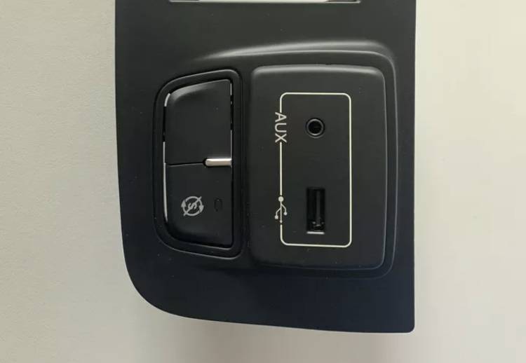

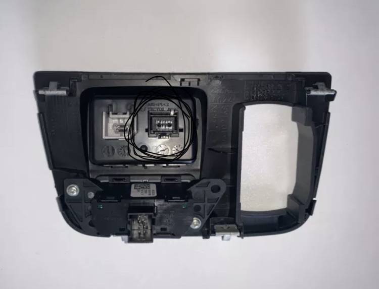

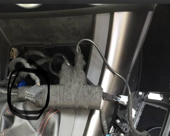

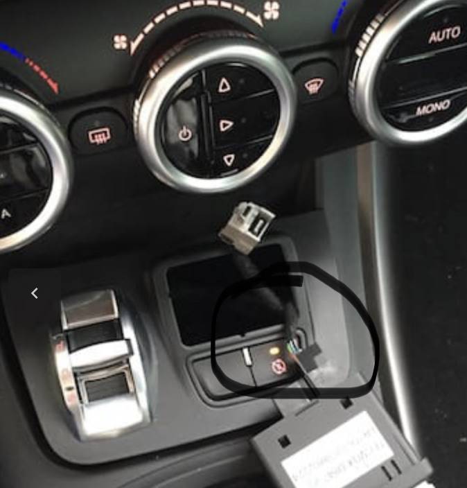

Volevo porre un quesito sulla mia Giulietta 2018 dotata di alpine non è presente la presa aux sulla mostrina centrale ma solo la usb, se volessi aggiungerla l’ingresso aux avrei bisogno di un connettore 8 pin come in foto che non riesco a reperire in rete come bisogna fare
