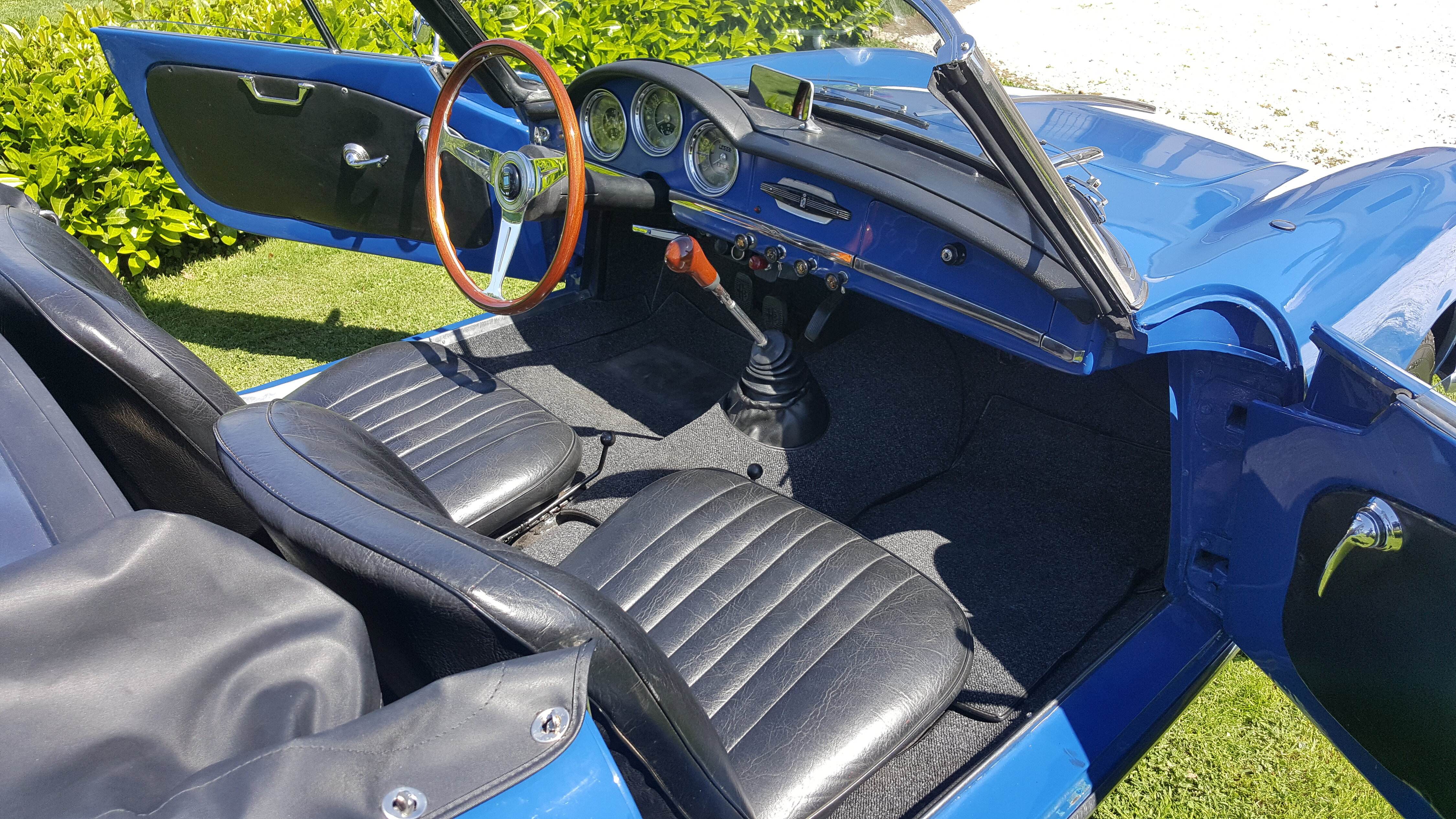

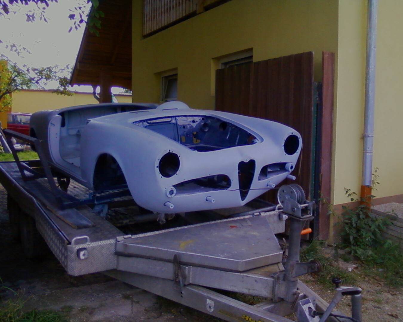

Wow, very nice! You already painted the engine compartment i can see.. about the curve over the dashboard is yours blue, black or leather covered?
I attached a pic before restauration and you can see wrong seats, wrong moquette, wrong steering.. the dashboard was black painted..

It will get black wrinkle Paint, it also had it from the factory

Don‘t think that the factory made cars with a colored dashboard top.
I just know wrinkle paint or leather.
