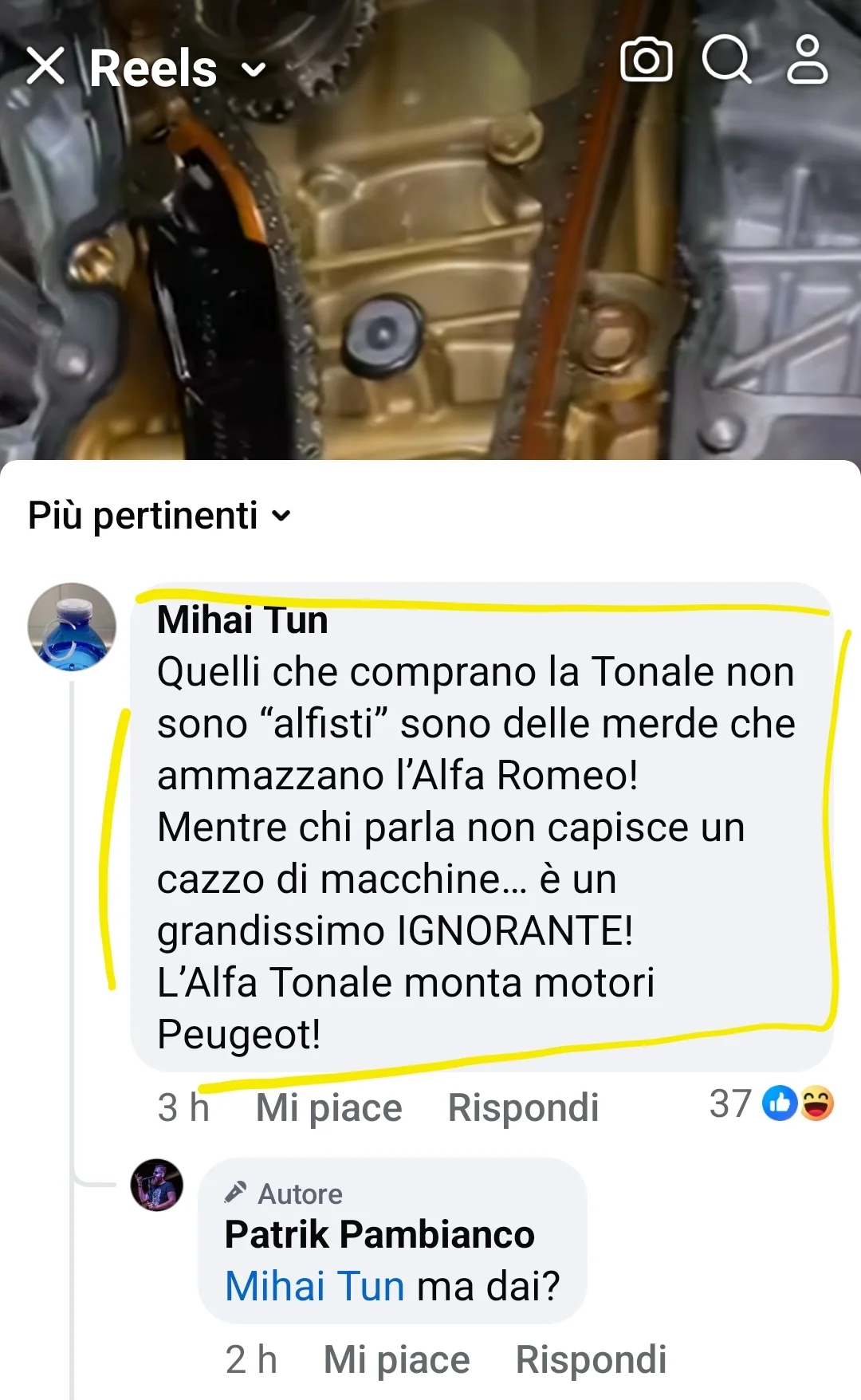

Wow, the main title of the reel is “influencer become an engineer looking a chain for the first time”.
Very interestings also the comment too, when the influencer and his followers says the engine is a modified puretech; they think to put shit on PSA.
Really do you think FCA engineers are so idiots to be demistified by an influencer that is looking a timing chain for the first time?
