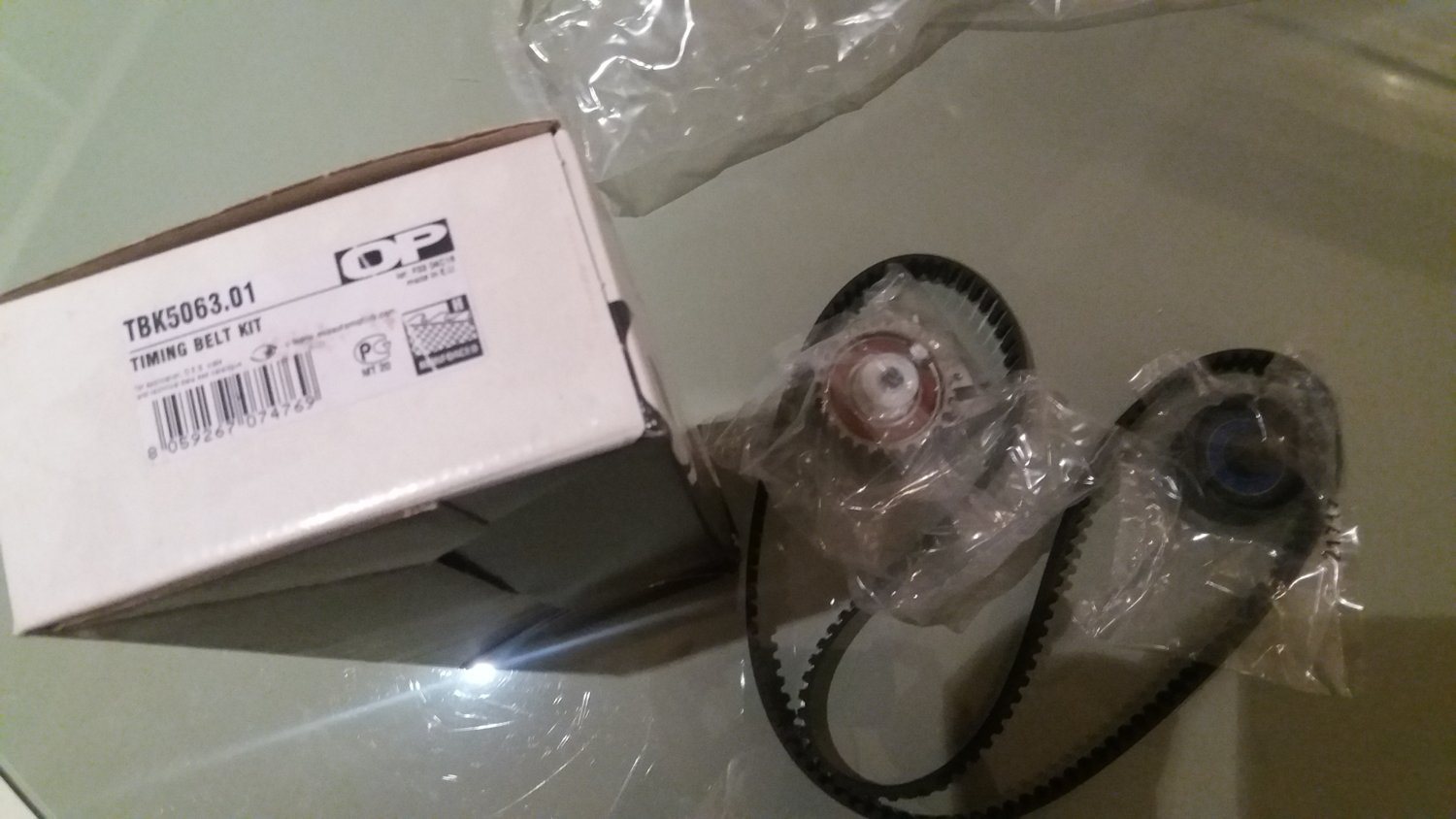

TBK5063.01 - KIT CINGHIA DISTRIBUZIONE

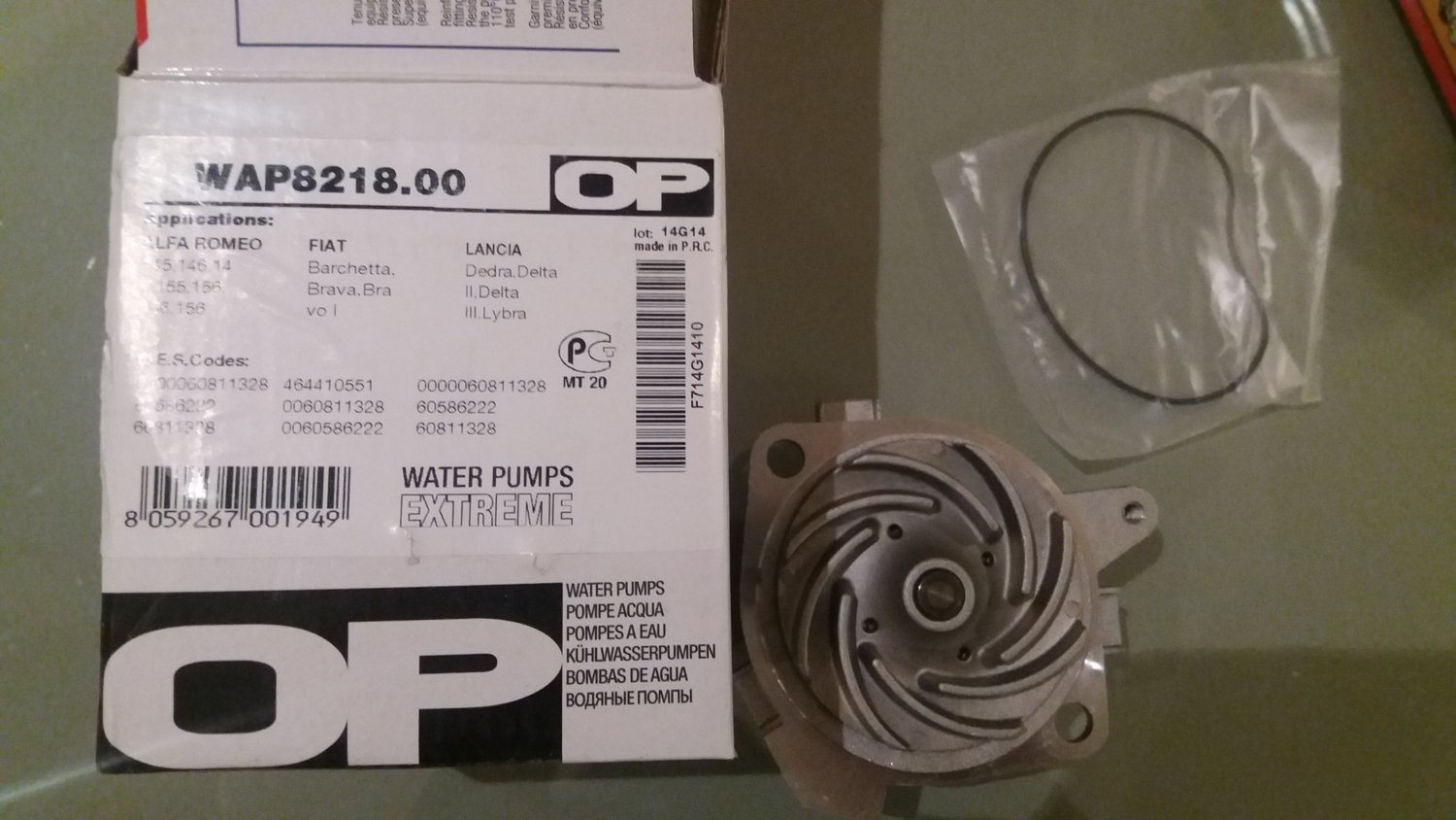

WAP8218.00 - POMPA ACQUA

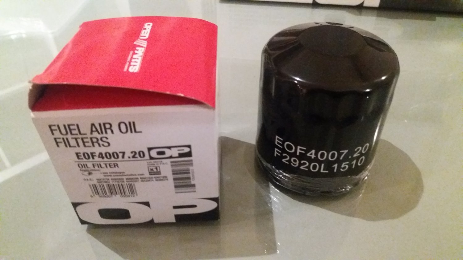

EOF4007.20 - FILTRO OLIO

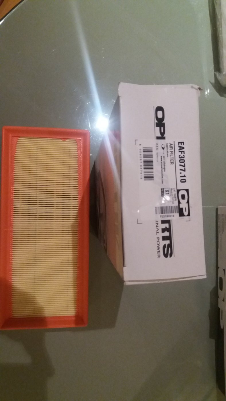

EAF3077.10 - FILTRO ARIA

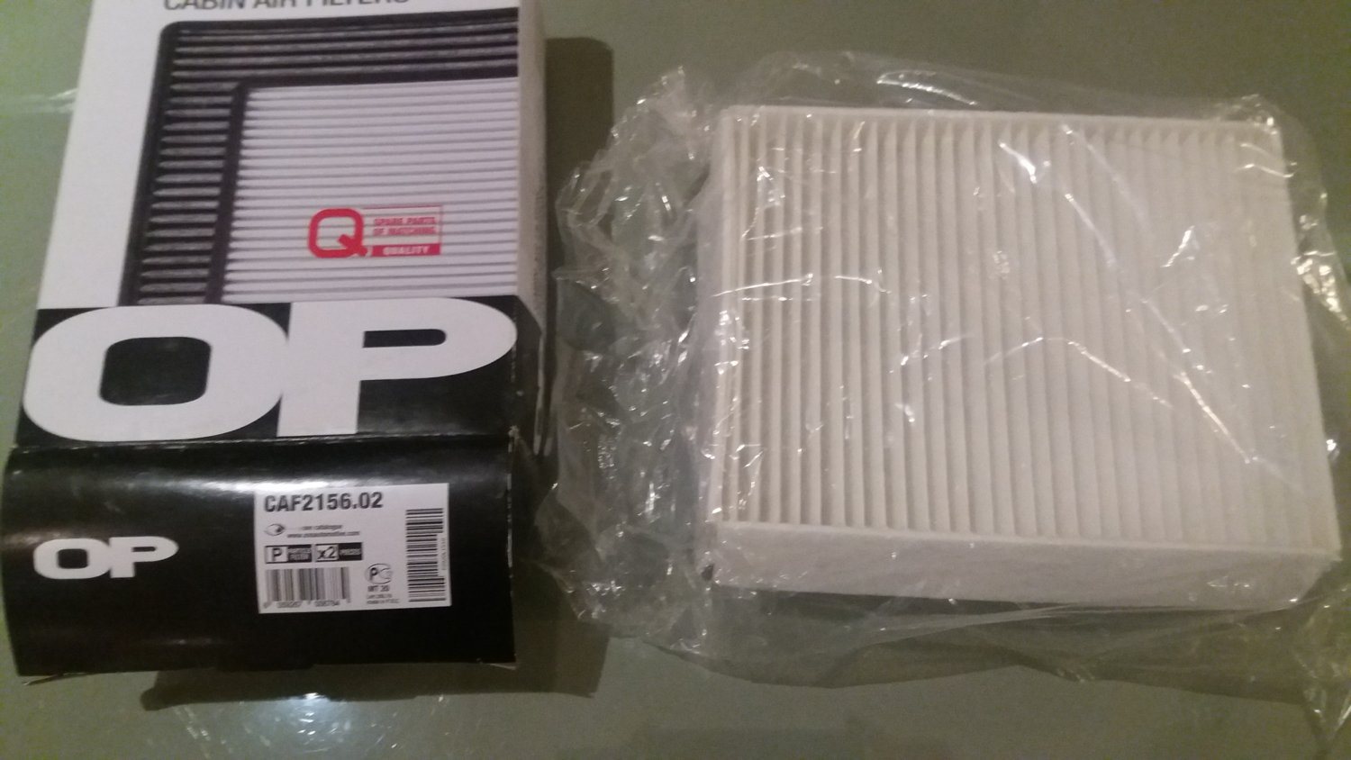

CAF2156.02 - FILTRO ABITACOLO

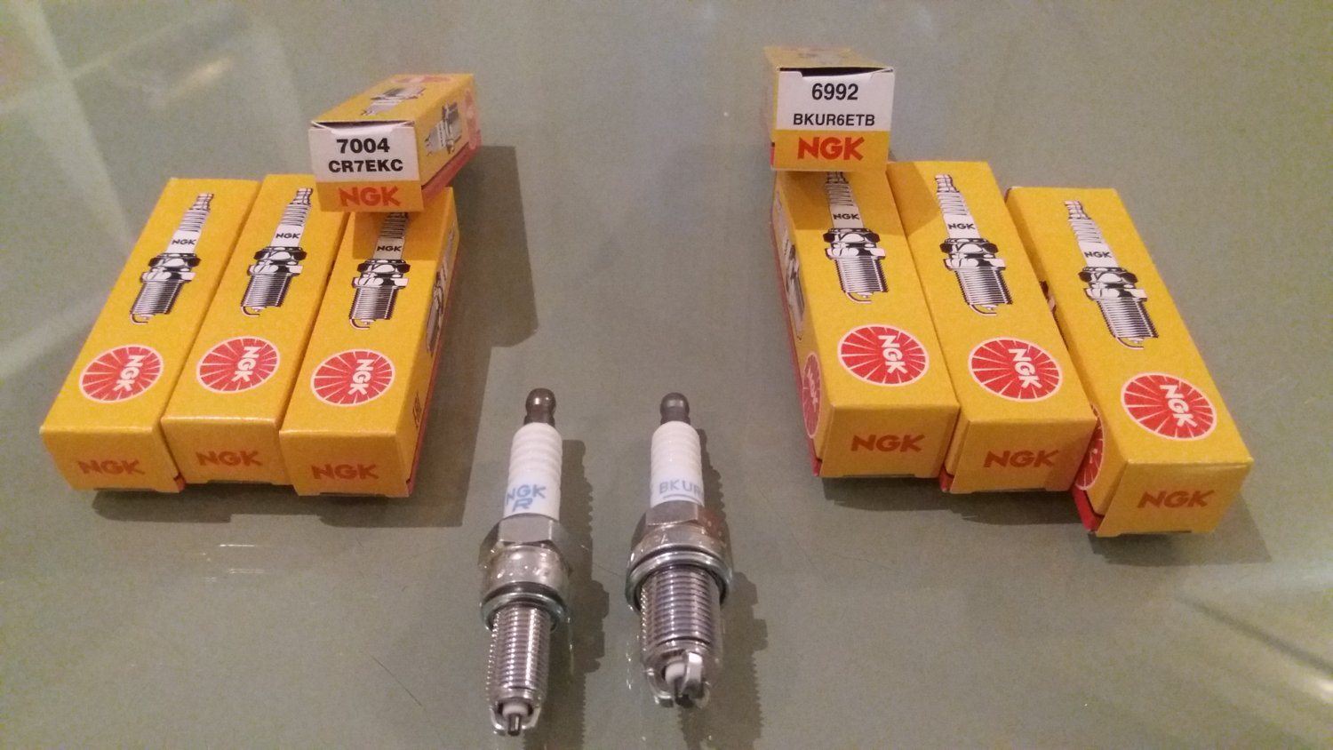

6992 - CANDELA ACCENSIONE NGK - 4 pz
7004 - CANDELA ACCENSIONE NGK - 4 pz
