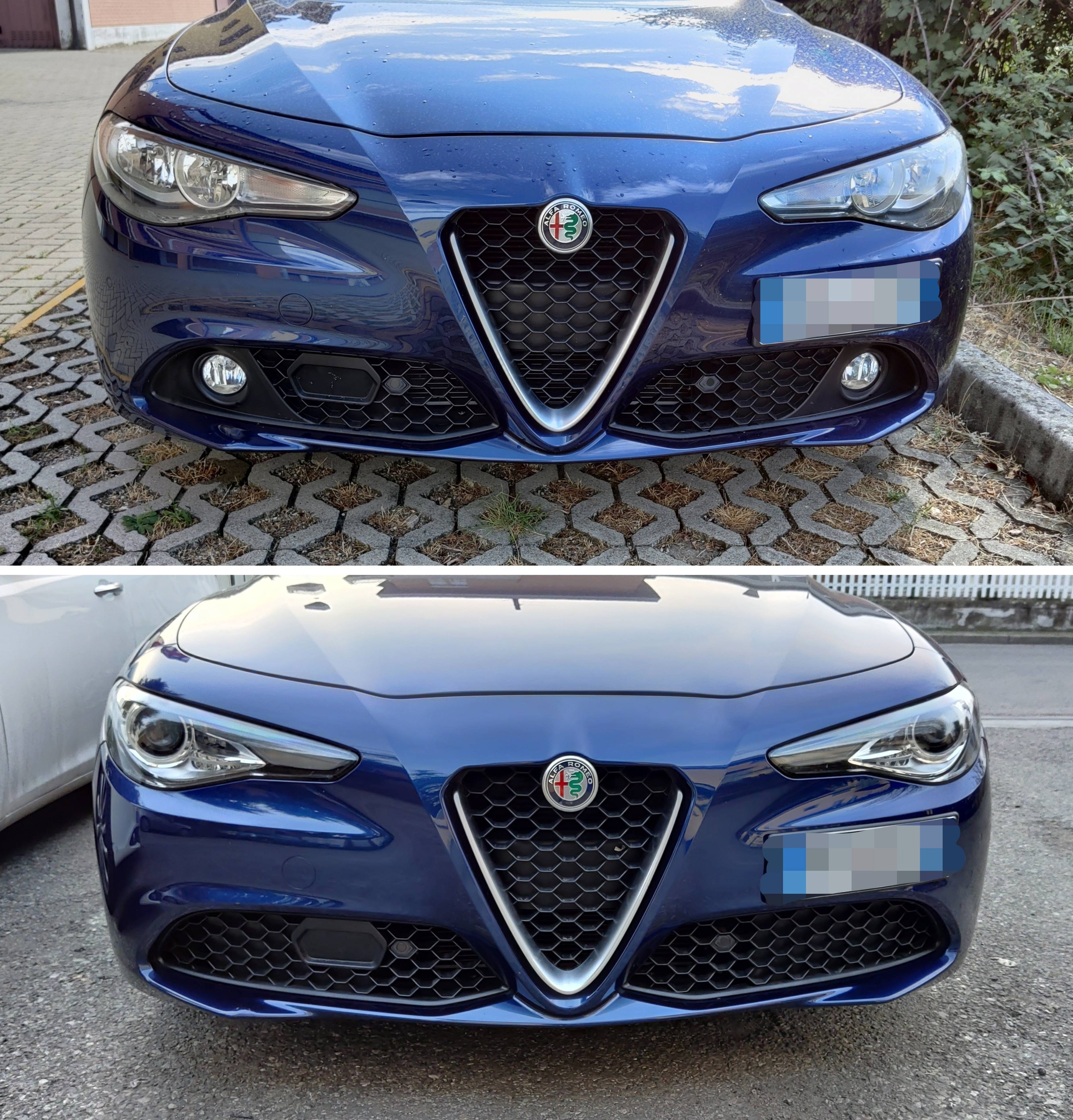

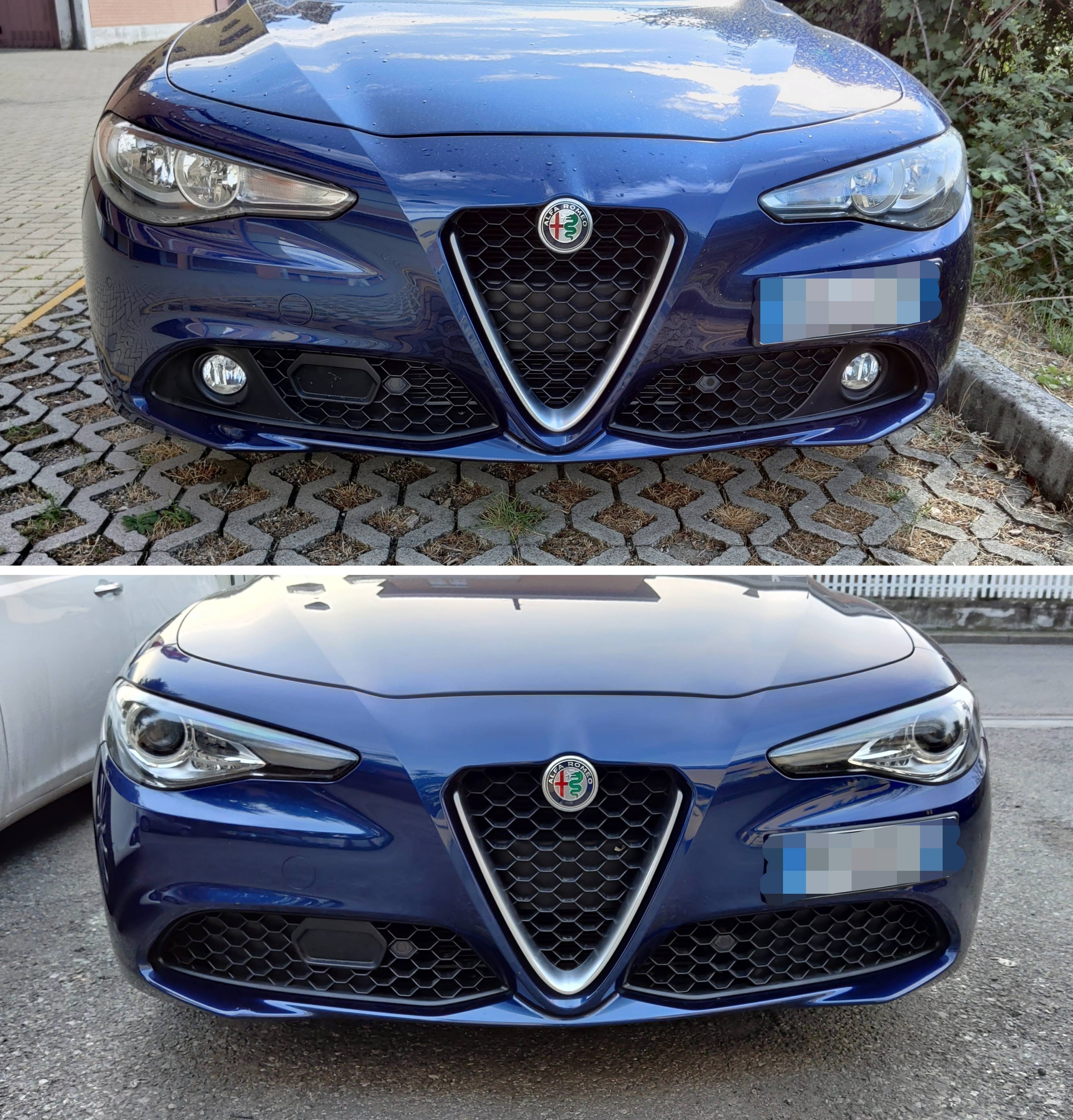

Hi,
do you have the OEM number for the lower grills like the one in the picture below that are installed when the fog lights are removed?
I made a conversion to xenon lights and I would like to remove the fog lights.
