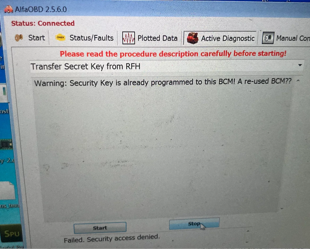

I have replaced the ETM MY20 and IPC MY20.
I purchased a second-hand BCM MY20 and paid someone to modify the VIN (but it was done on vehicle not on bench). When I tried to use Alfa obd to transfer secret key from RFH, it reported an error. Is there any way to solve this problem?
Thanks.
