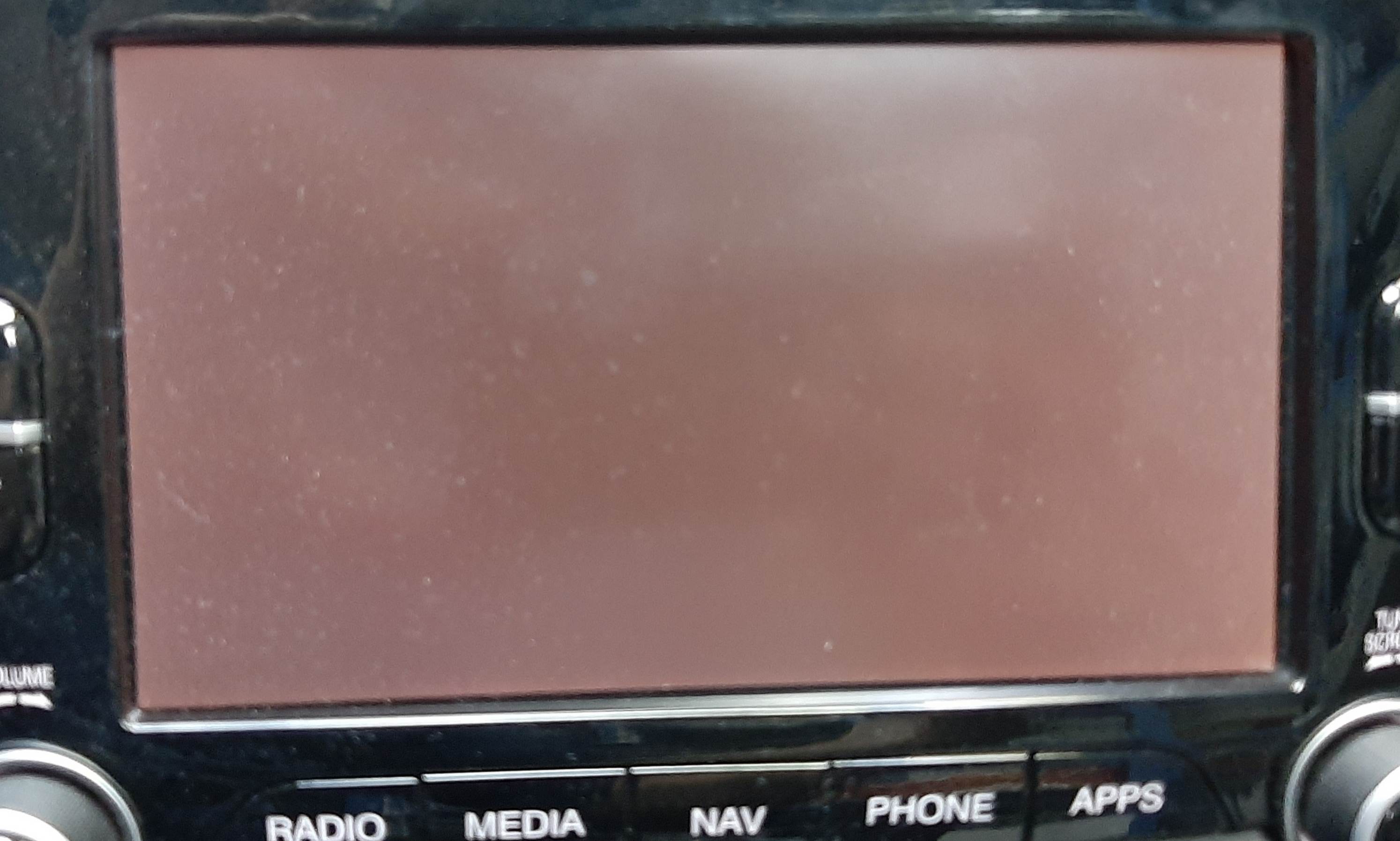

my car fiat 500x 6.5 vp4 radio got wrong update result has become this how should i do bi please help
