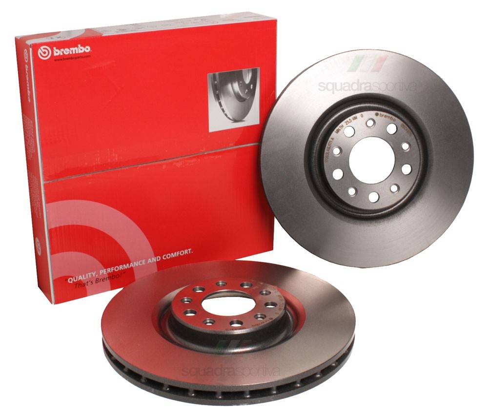

Ma come gli anteriori non sono da 330mm?? Per tutti?? (Bestia da 500cv a parte)
Eccoli:
Brembo Brake Disc Set - Front​
115,99 EUR
58,00 EUR per piece
incl. VAT excl. Shipping costs
Product: R545-356
MPN: 09.C497.11
Model: Alfa Stelvio
PRODUCTS DESCRIPTION​
High-quality brake disc set from the leading producer of aftermarkt brake discs and drums in Europe.
Brembo coated discs are protected by a special anti-corrosion coating on the hat and outer rim of the rotor which preserves the original visual appearance and functional characteristics, while also saving time during installation as the disc no longer requires cleaning and degreasing.
The price is per set (2 pieces)
Dimensions: 330 x 28 x 44.7 mm
Suitable for the following Stelvios:
  • 2.0 TB MA with 200 and 280 bhp
  • 2.2 JTDM with 150, 180 and 210 bhp
Qui i posteriori:
Brembo Brake Disc Set - Rear​
from 99,00 EUR
49,50 EUR per piece
Product: R545-384 / R545-385
MPN: 50545300 / 50554320
Model: Alfa Stelvio
Please note the VIN in the order form!
Variant 1:
292 x 22 x 43.2 mm (disc diameter x disc thickness x height), vented
2.2 JTDM
Variant 2:
320 x 22 x 43.2 mm (disc diameter x disc thickness x height), vented
2.0 TB MA
Eccoli:
Visualizza allegato 225893
115,99 EUR
58,00 EUR per piece
Product: R545-356
MPN: 09.C497.11
Model: Alfa Stelvio
Visualizza allegato 225892
