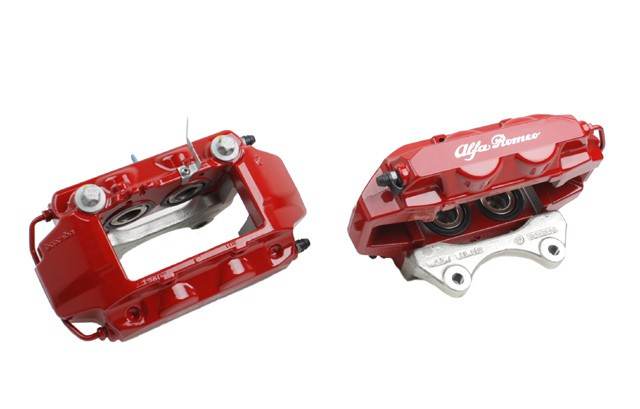

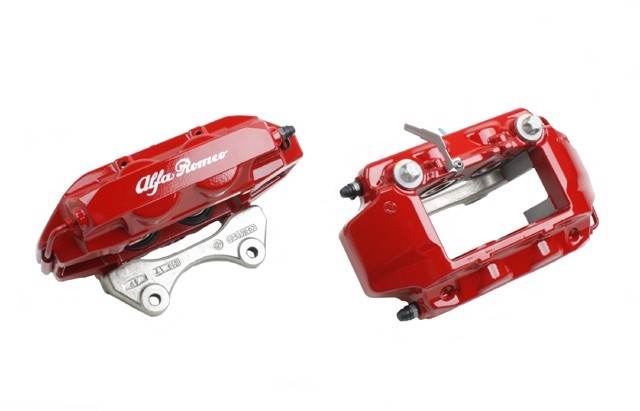

ciao, le staffe sono le stesse.
1500 euri?? lascia perdere..
non ne vale la pena.. le pinze che devi prendere sono queste:
stavano a 700 fino a qualche settimana fa!! vedi ad aspettare porca puttana..

Genuine Alfa Romeo brake calipers (one left, one right) for the front suspension
For all Alfa MiTo with factory mounted Brembo brake system and 305 mm brake discs:
  • 1.4 TB (155 bhp)
  • 1.4 TB Mulitair TCT (140 bhp) from about 08/2015, for some models (not all of them)!
  • 1.4 TB Multiair (170 bhp)
Those calipers can only be mounted when the very car was already delivered with Brembo calipers and 305 mm diameter brake discs
- it is not possible to mount the calipers on cars with 1-piston floating brake calipers and smaler brake discs
The calipers are brand new - not remanufactured - meaning no securtiy or returning of the old calipers of your Alfa
Brembo MiTo Caliper Set For 305 mm Brake System
Delivery Time: 1-4 W/days (stock item)
Product No.: R515-010_R515-011
MSRP 1.311,02 EUR
only 899,00 EUR
incl. VAT excl. shipping

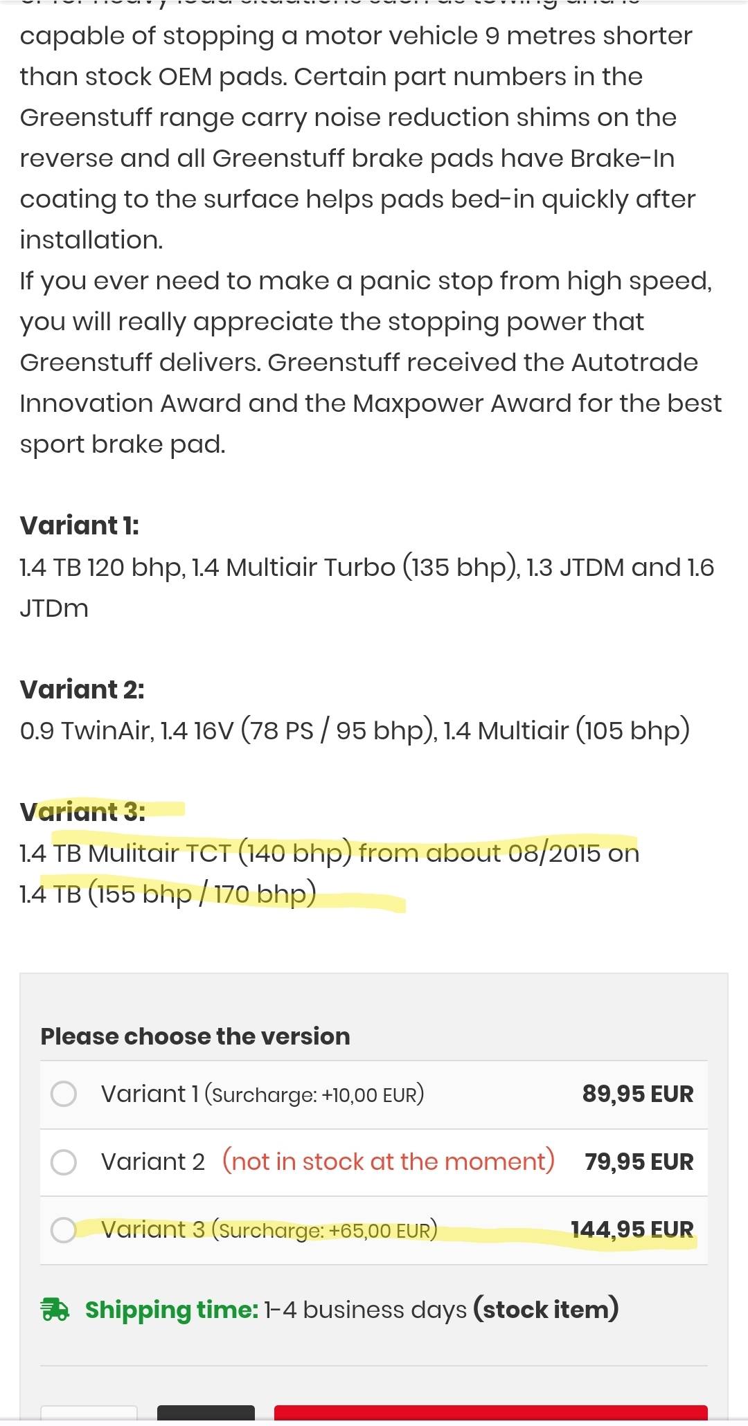

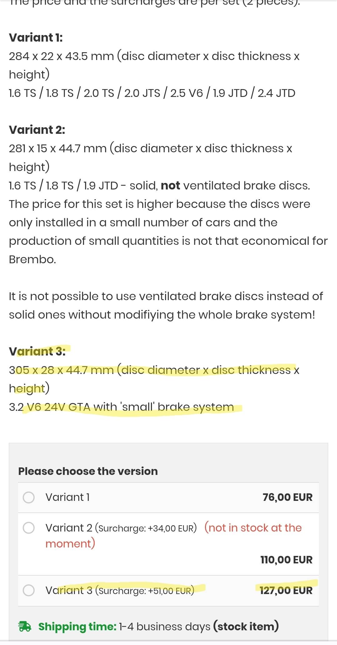

Le staffe sono già comprese insieme alle pinze brembo originali non devi fare altro. Idem le pastiglie. Devi semplicemente andare su questo sito internet e ordinare l'occorrente.
Qui le pinze:
Relative pastiglie:
Qui SOTTO INVECE CI SONO I DISCHI specifici ALFA 156 GTA 305mm
