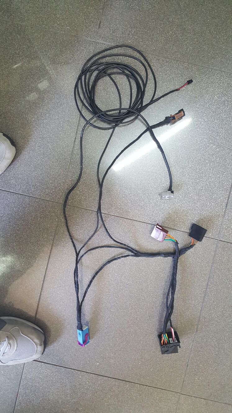

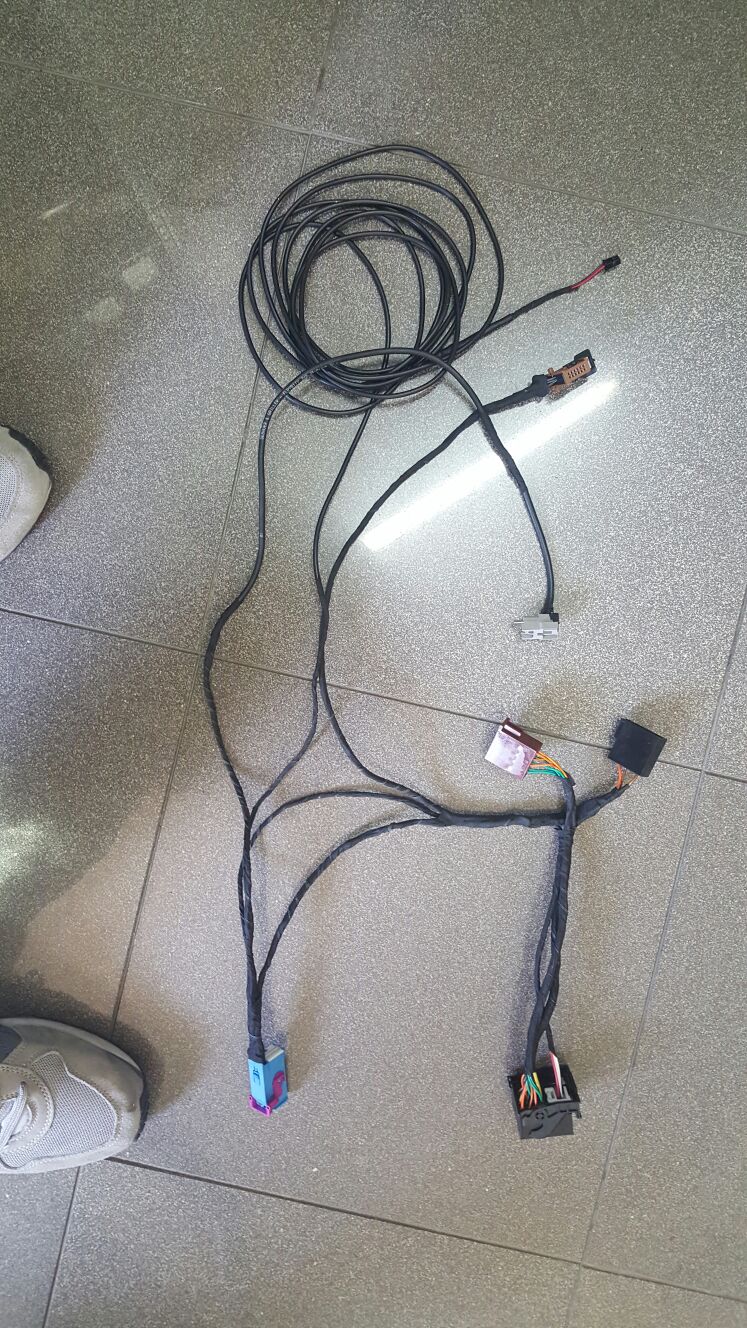

Hi guys! I inform you that I create wiring specifically for your needs, 100% working
including Blue & me kit or wiring from normal stereo + radionav + blu & me both plug & play
the kit for blue & me includes:
- Ceiling light with microphone;
- Blue & me control unit + brackets;
- 4 + 4 steering wheel buttons;
- USB socket with Aux;
- Wiring for assembly.
if instead you would like to add the radionav, I will create the wiring for both
Both of the harnesses that I will create will be easy to install, in such a way as to make assembly less tiring.
For all the info write me in private!
Greetings ^^
The photo is illustrative only Visualizza allegato 138613
