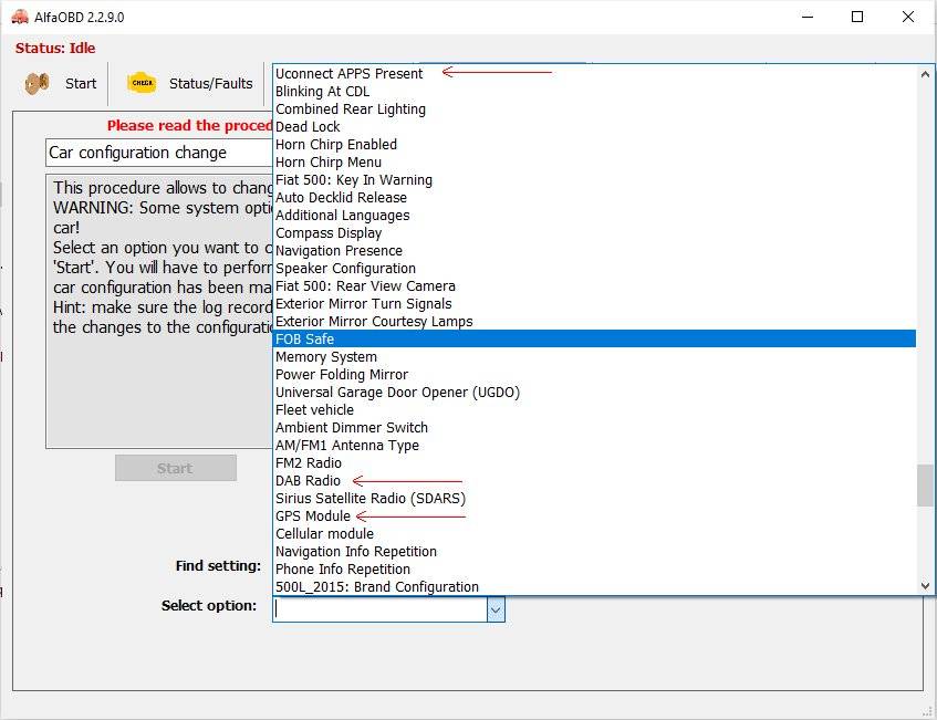

Forgive me again for writing in English. I had to reinstall version 17.05, however, after that I lost effective drive option. Just to note that this is a retrofitted u connect 6.5 with apps, but I was never able to enable u connect live services but Alfa performance and effective drive. Is there something I can do to recover effective drive?
Thanks in advance.
Hi, can you use ALfaOBD? You can try activating these options and then see if work. Good luck!
    60.8 KB · Visualizzazioni: 219
All of these three options and they were already enabled. As well as the effective drive option. When I press settings at u connect live it’s Emma that the effective drive server is empty
