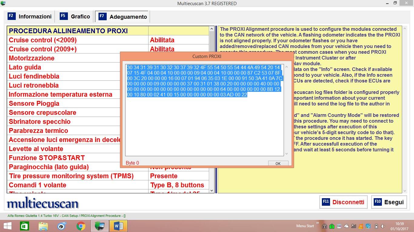

Bit 74 = 0A efficient drive
Bit 118 = 80 APPS

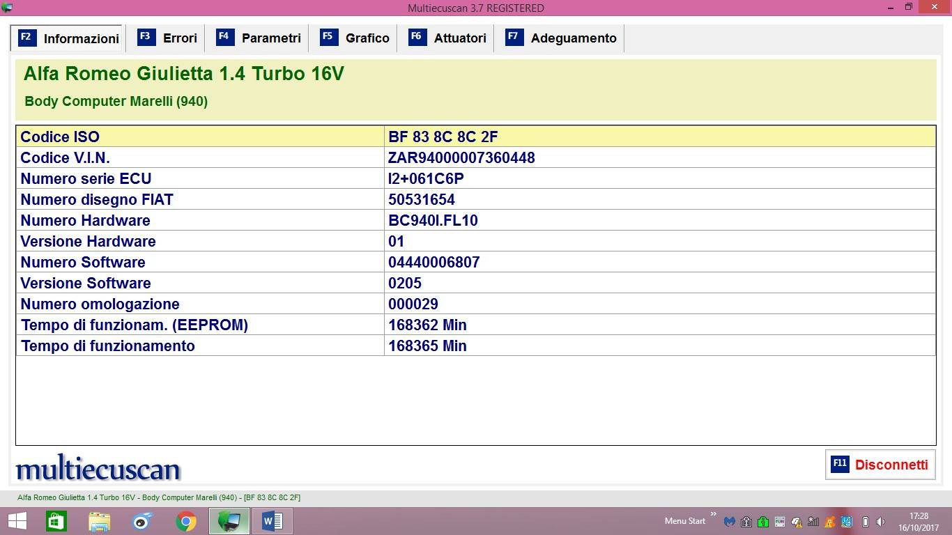

I think for all indicators working on Alfa Performance need body almost with fw 2.16 or up.
Thanks.
Body is the same, so fw is the same and normally I should have the same indicators for all the three different head units I tried.
I did not get Bit 74 and Bit 118. Can you please explain?
See these pictures.
Count 74 and 118 byte in the first.
And verify the fw in the second where you see 0205 and you need 0216 and up

Ευχαριστώ. Μπορώ να αλλάξω αυτές τις τιμές με το mes;

Ευχαριστώ. Πώς μπορώ να κάνω προσαρμοσμένο διακομιστή μεσολάβησης με το mes; Δεν μπορούσα να το βρω.
,Live services end by the end of the year for everyone? I am not sure
Do you have any idea about the flashing odometer? I am saying again that I tried MES Alfa obd and wi tech but all of them failed
You can do it with MES but only increasing the existing total km registered on the odometer.
Sorry for my many questions. I can’t understand how total Km are connected with custom proxy on mes. Can you please provide screenshots step by step?
