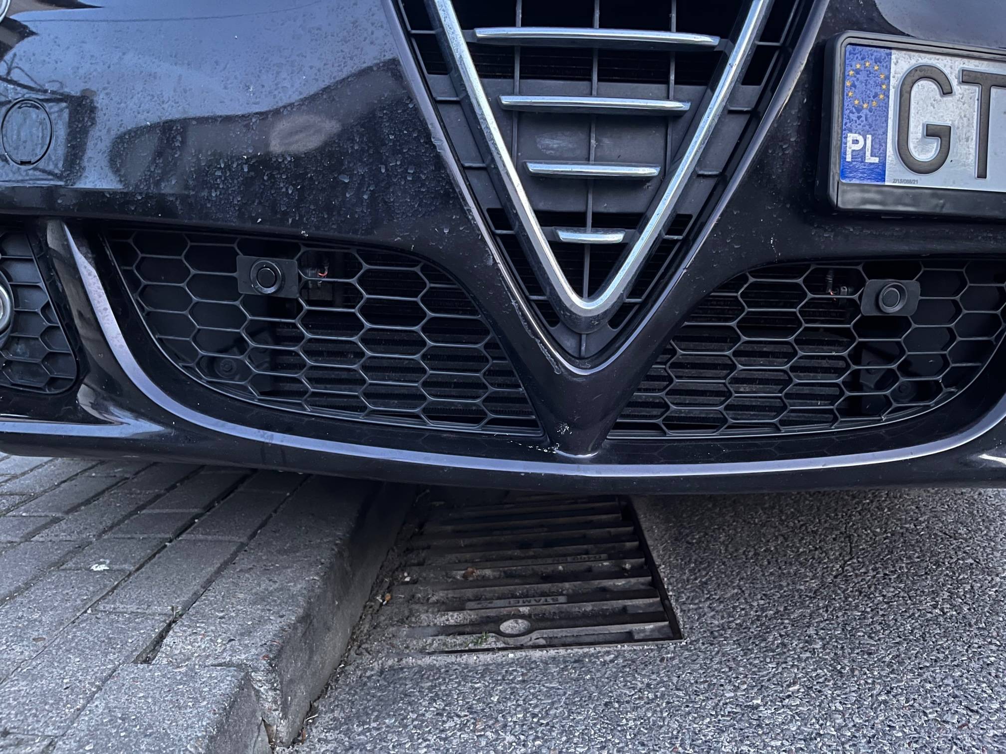

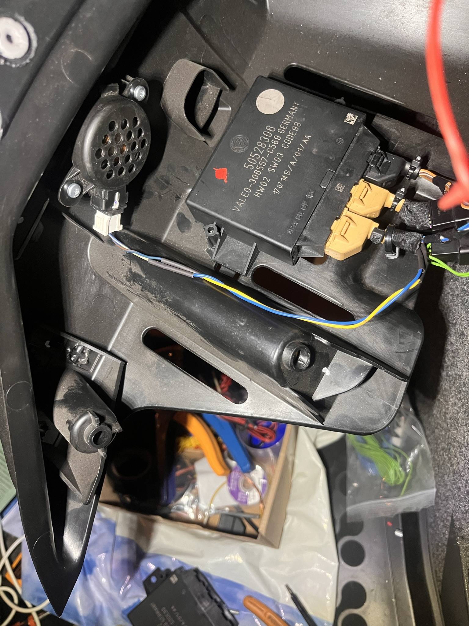

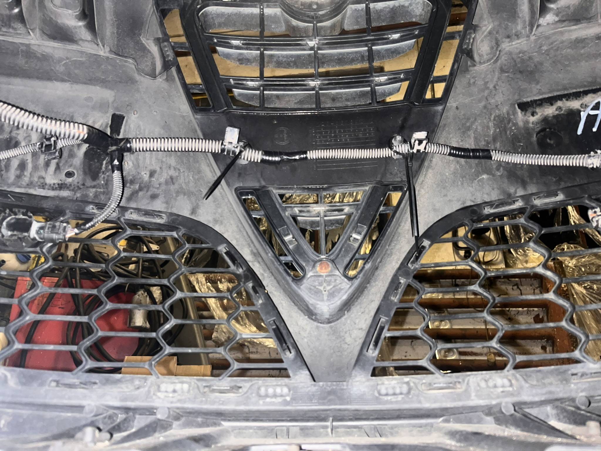

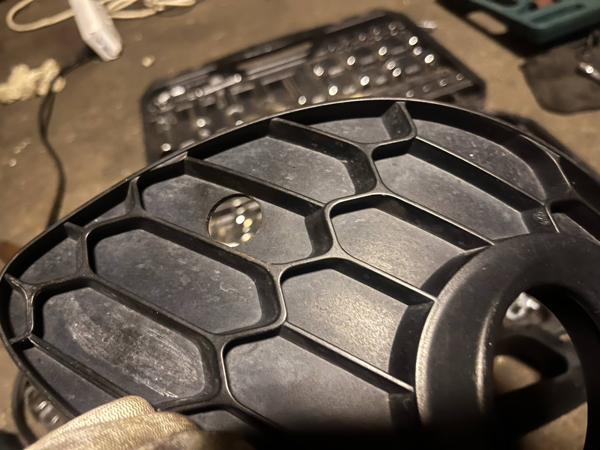

I installed it with use of original rear harness (it's to short to install sensor in bumper, but I use fog lights covers).
Sensors works, but there was need of small adjustments to make sensors looking straight not into ground. Unfortunately I broke cover mounts so they need be changed and probably then I try to install sensor in place where they should be - in bumper ;)
I install speaker in front (above BCM), buttons will arrive soon. Everything works as it should, but without visualisation in cluster.
Open question is how it will work with newer cluster - visualisation will work then? How about sound, because now notificaiton for rear sensor I have both in cluster and rear speaker (which need to be installed to make it work).

#502
Have you upgraded body computer with one of restyling type with 133 bites?
The bit number 118 active the ant+post visualisation on matrix.
Reazioni: rpg90
#503
@spiderman58 Nope, there is still old Body (50521949) and cluster from 2012.
So if Your note is correct, even if cluster will be changed there still be no chance to setup it to work without new body.
I read a little about it and it's not easy to change Body from old to new.
And thank's for picture - I was thinking about use of some signs inside bumper, but it's way far from what You show in PDF file.

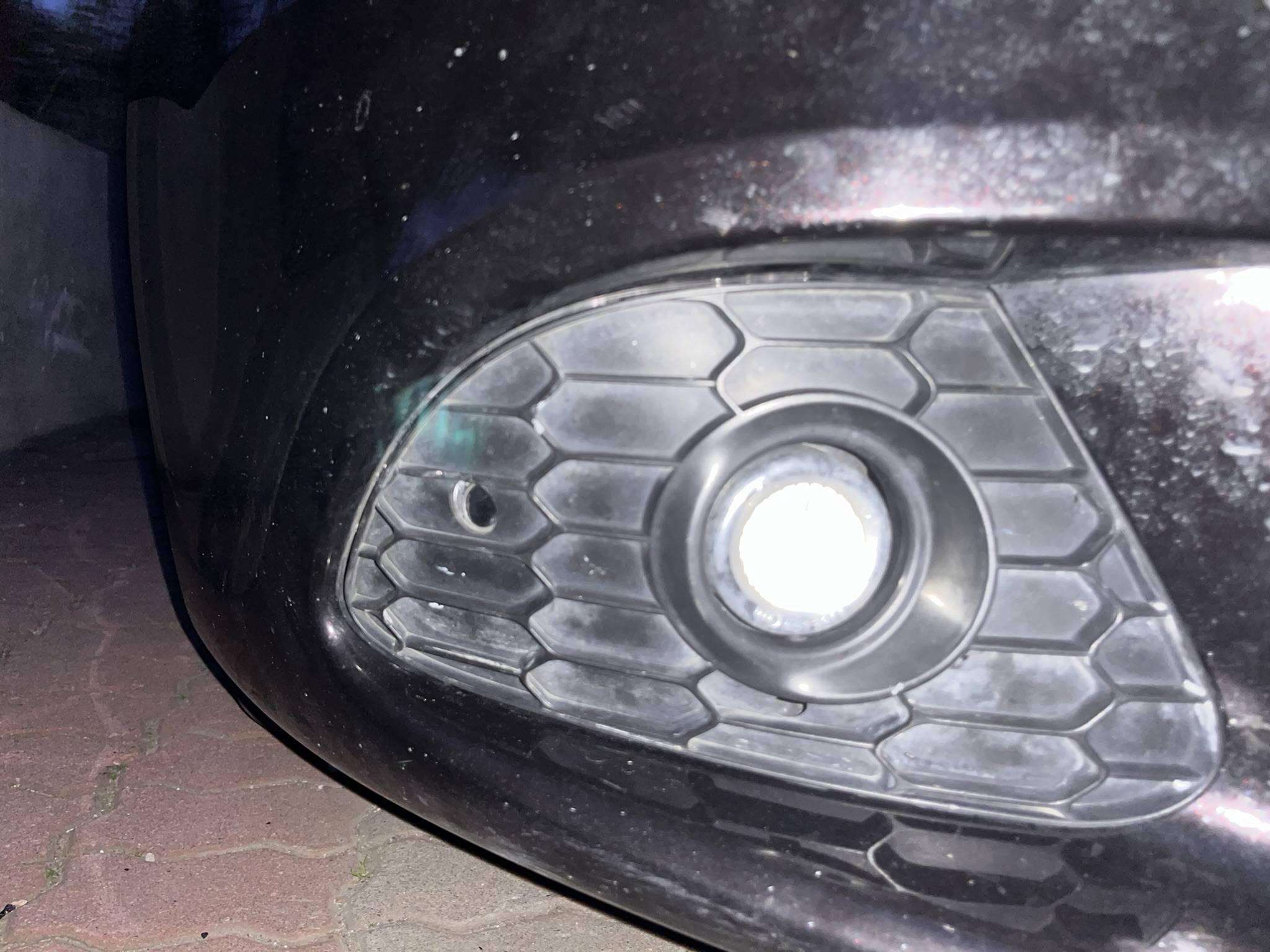

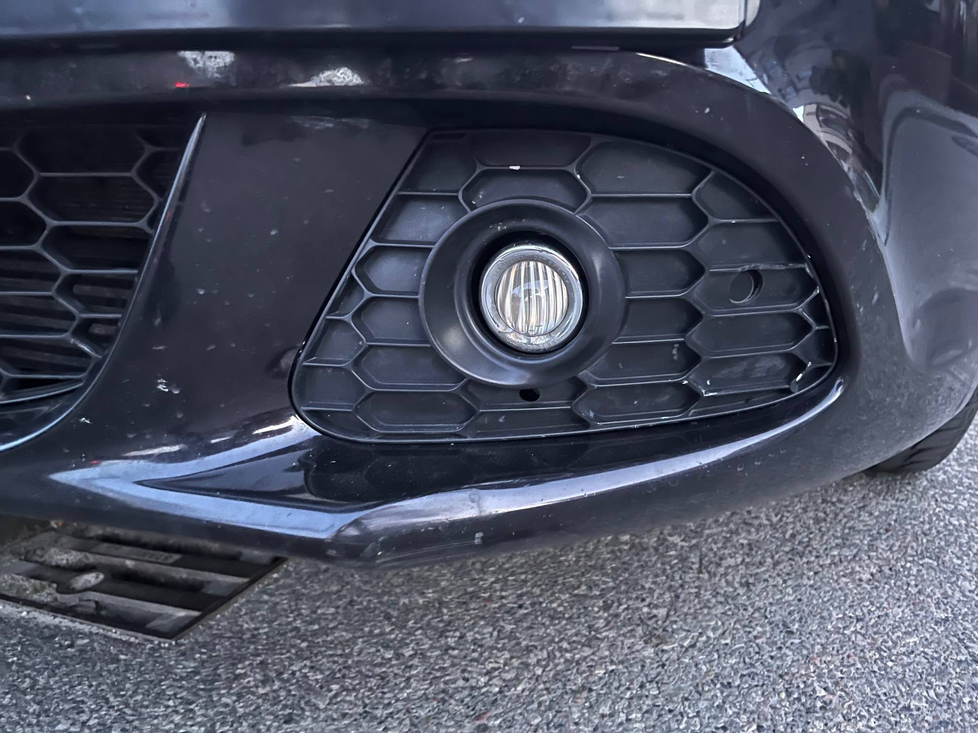

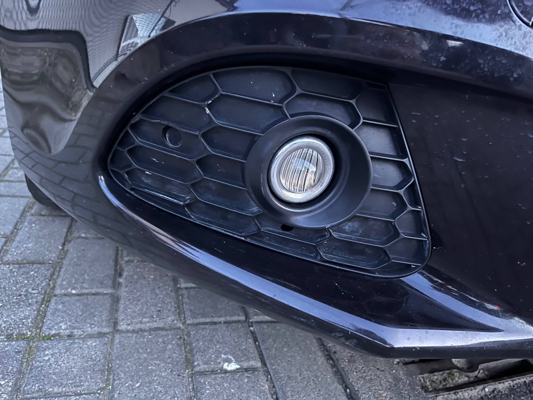

@spiderman58 BTW - is there any description which byte in Body is responsible for what?
Below pictures how it looks now in daylight.

#505
I know some bytes not all.
I made my pdf from original front bumper.

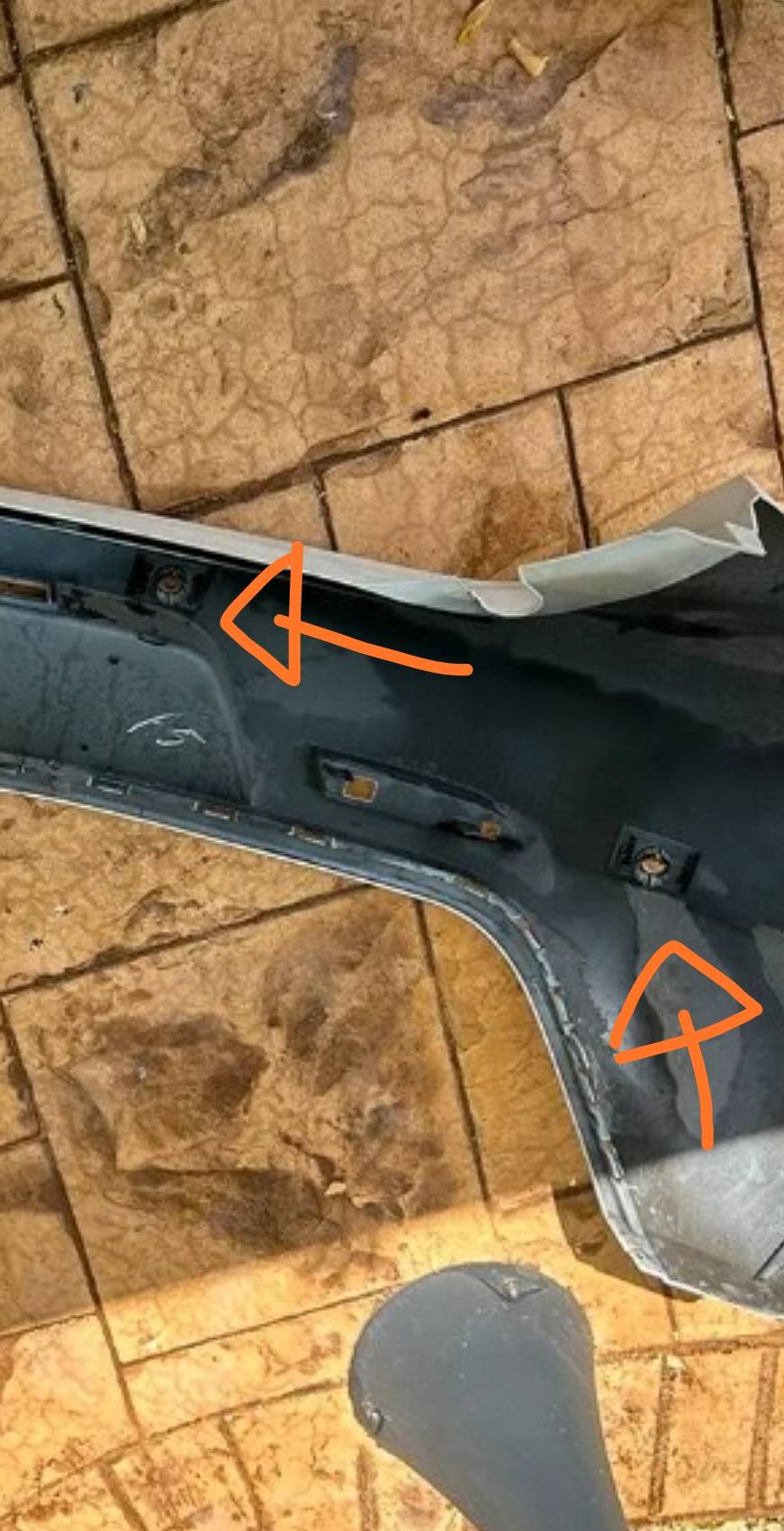

Non sono sicuro se l'argomento è stato trattato ma non ho trovato nulla..
La mia Giulietta non era dotata di sensori..e quindi ho montato quelli aftermarket universali che si trovano sulla baia..li uso da circa 3-4 anni e mi sono sempre trovato bene.. considerando che mi hanno tamponato da dietro e quindi spaccato il paraurti posteriore..
Su subito ho trovato un tipo che ne vende uno originale ma con i fori e quindi gli imbocchi per i sensori originali..la mia domanda è:posso usare quei fori e montare quello scadenti aftermarket?qualcuno di voi lo hai mai fatto questo tentativo?
