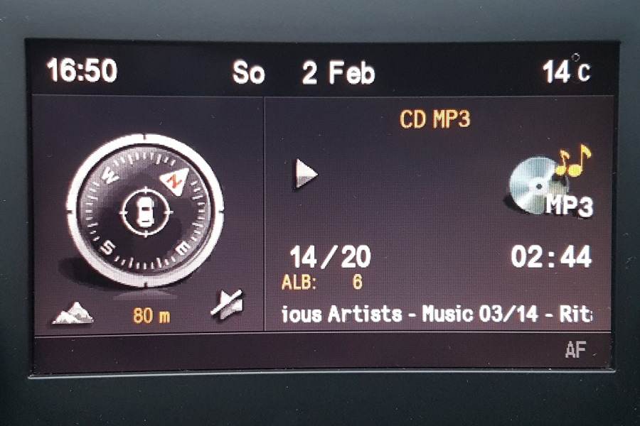

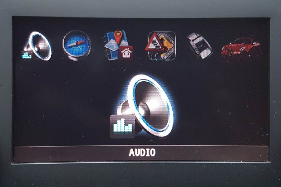

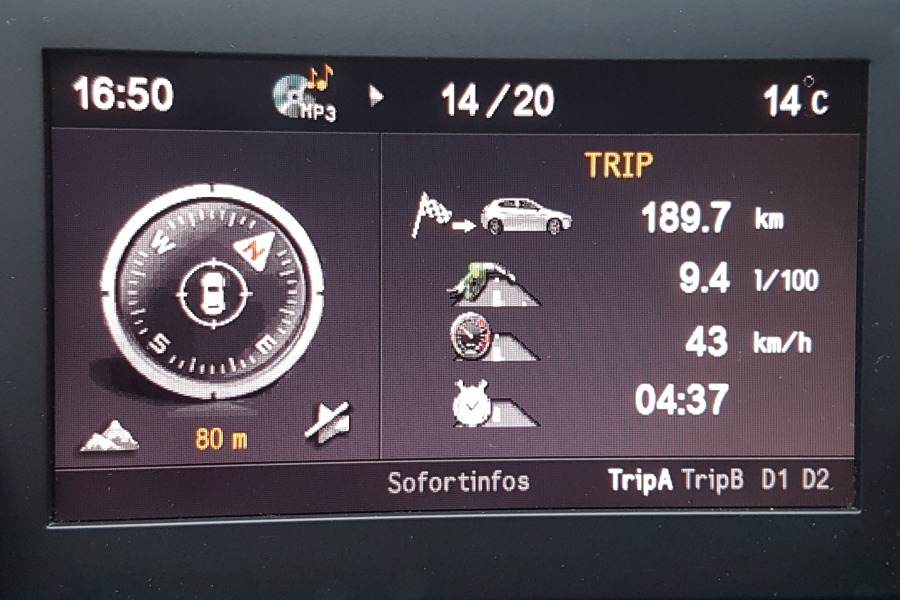

Hi kyto83!
(sorry for writing in english) I have mixed up another theme based on the original one (changed blue/green to dark-gray/orange). At some places I decided to use some of your graphics instead of the original ones. At a few other places I made completely new ones. I just wanted to ask if someone is interested and if kyto83 would mind if I upload it here.
See attached images for an impression:
Cheers,
TheFish
Reactions: RiccardoF
