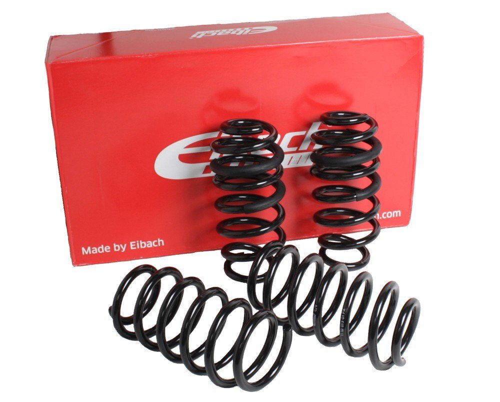

Albo, scusa dove le hai prese le molle,di che colore sono e quanto le hai pagate??
Eibach Giulia ProKit Federnsatz - Alfa Romeo Shop - Tuning, Styling, Fanartikel und Modellautos
Prova con queste:
Eibach Pro Kit lowering spring kit for all Alfa Giulia 952 (except the Quadrifoglio), also Veloce
Lowering by about 20-25 mm at the front and about 25 mm at the rear
The ProKit can either be used in combination with original (standard) shock absorbers or with sports shock shock absorbers (e.g. Bilstein B6 or B8)
Progressive caracteristic: the firmer the more the springs are deflected
The ideal balance between improved handling and comfort
