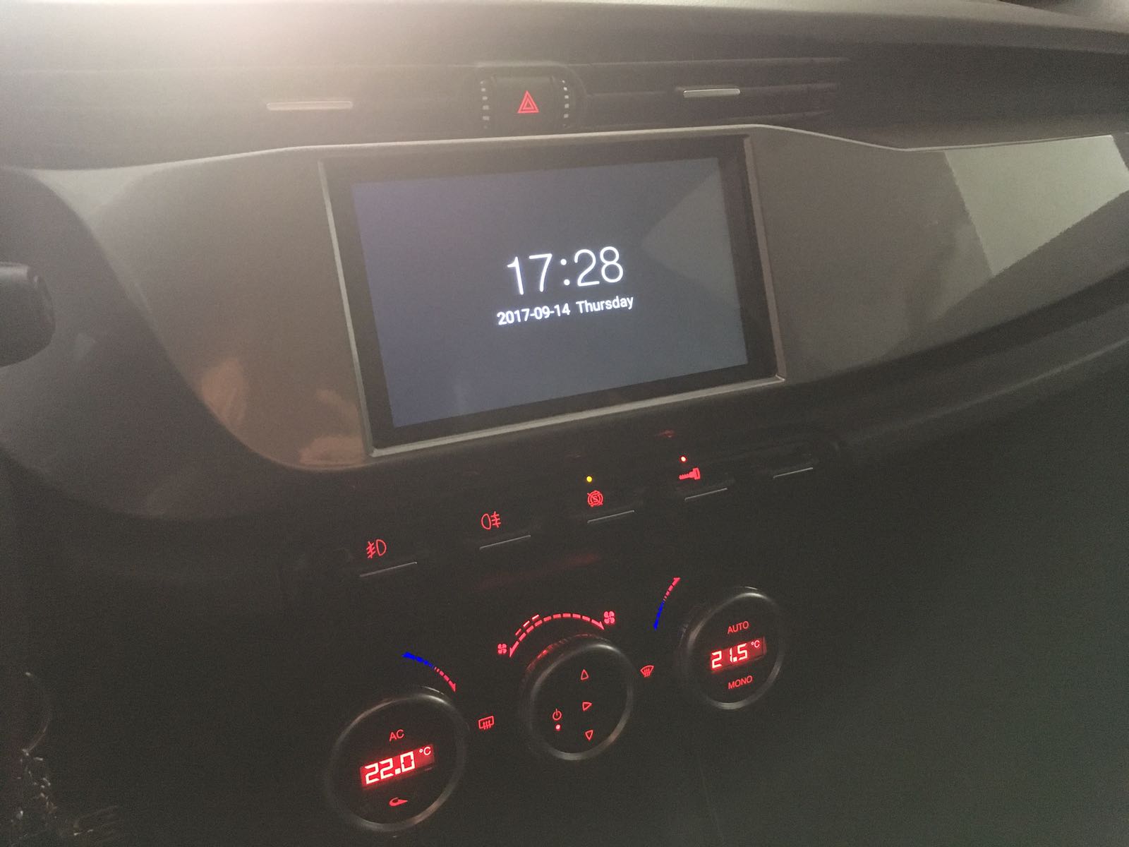

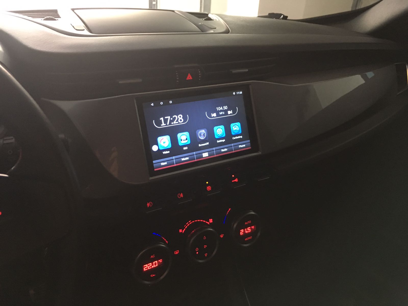

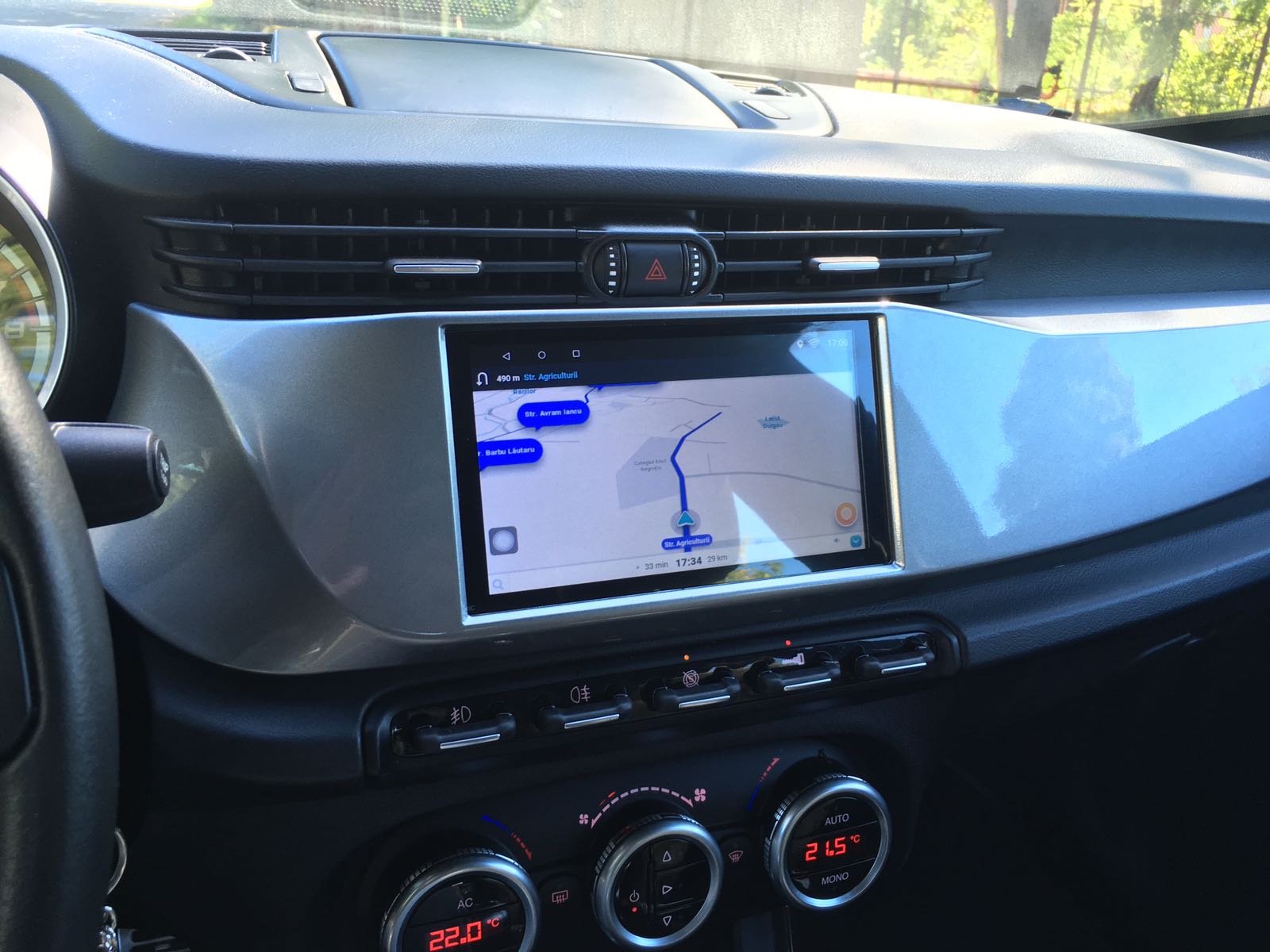

And results:
Connects2 fascia + Edonav E300 (Quadcore + Android 6) and all steering wheel buttons work
Thanks guys for all the help !
