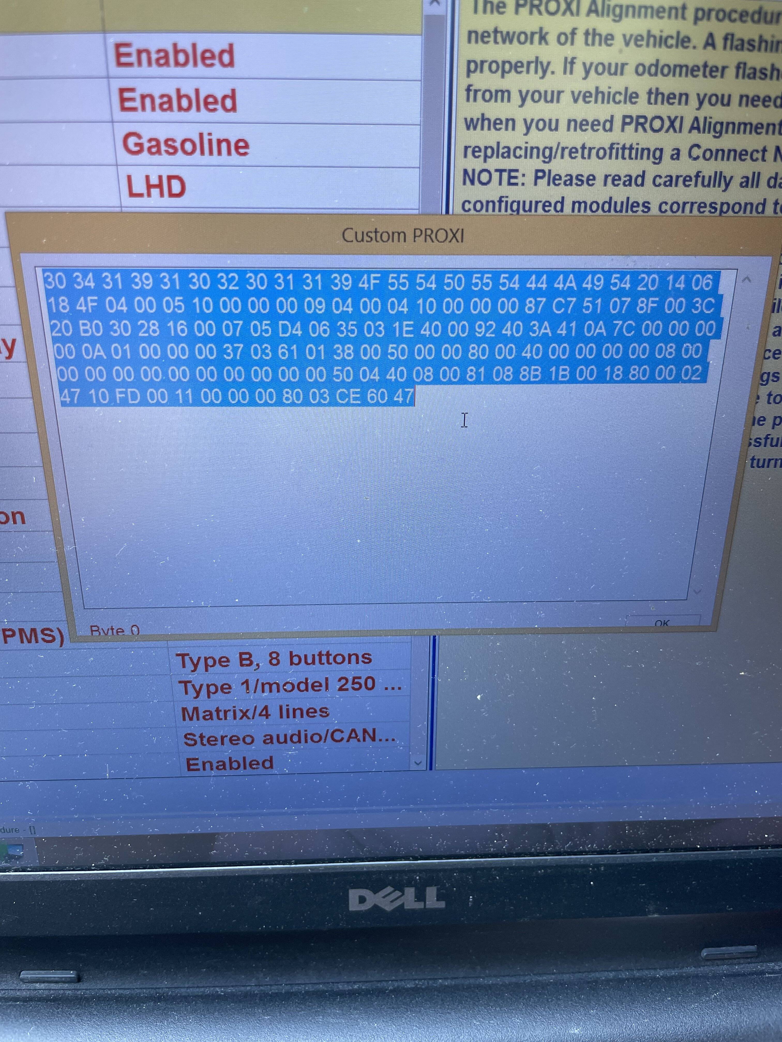

Hi please check my custom proxy settings. I can’t see any problem at the bits 74 and 118. However there is still an error in proxy alignment of the u connect.
