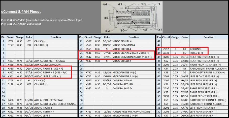

    97.6 KB · Visualizzazioni: 141
Great thanks. From where can I get ACC to +12V controlled by ignition switch (after fuse)?
Uconnect is not under ACC but is always under +12V. If You need +12v under ACC use positive of lighter. You know, without key on ignition switch uconnect power on/power off with its power button.
