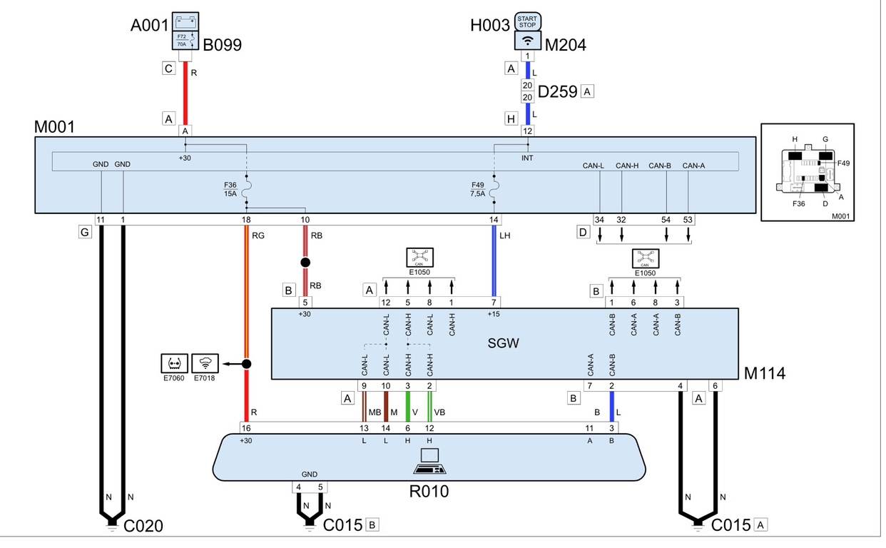

On Stelvio MY19, port 3 and 11 seem to be firewalled as well.
Its possible to read but not to clear errors.
Sorry, is firewalled.... look this
#198

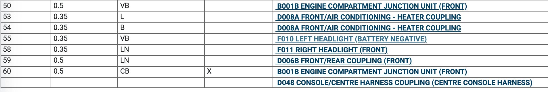

53/54 seems to be climate control. But 51 and 52 are not mentioned.
I will check if there exist 2 wires on that ports.
