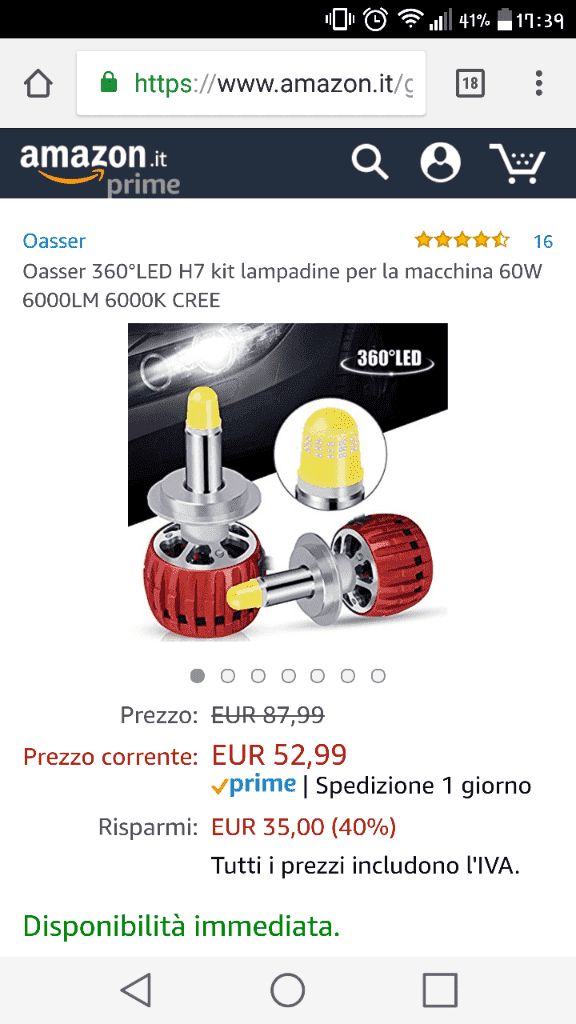

ALFISTI COSA NE PENSATE DI QUESTI ANABBAGLIANTI??
