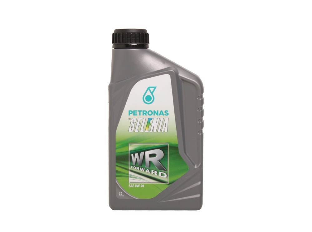

Selènia WR Forward 0W20 - Alfa Romeo Shop - Tuning, Styling, Fanartikel und Modellautos
Alfa Romeo Giulia Service & Maintainance Parts - Alfa Romeo Shop - Tuning, Styling, Fanartikel und Modellautos
12,99 EUR per Litre
Product No.: 83450
12,99 EUR
incl. VAT
1 litre (35.19 fl.oz.) engine oil Selènia WR Forward 0W20
Selenia WR Forward 0W-20 is the new fully synthetic lubricant specifically
designed for last generation diesel engines (Euro 6 standards)
and particularly for high-performance engines used
in the luxury and sports cars segment.
The new Selenia WR Forward 0W-20 was developed
with a low saps (low content of sulphated ash) formulation which allows:
  • high protection for the DPF system (Diesel Particulate Filter)
  • very high thermal stability
  • reduction of internal components frictions and this under every driving condition
A better protection of the engine during the oil-change interval is
also guaranteed thanks to a high degree of shear strength.
The maintenance of engine performance
is in this way guaranteed in short and long driving distances.
Technical data
SAE 0W-20, ACEA C2 Performance
Approvals: FIAT 9.55535-DSX,
Contractual Technical Reference N. F013.K15
Alfa Romeo's recommendation for the following engines / model series:
  • 1.6 JTDM EURO 6d temp (with AdBlue) in Alfa Giulietta
    necessary quantity for one oil service about 4,2 litres
  • 2.0 JTDM EURO 6d temp (with AdBlue) in Alfa Giulietta
  • 2.2 JTDM in Alfa Giulia 952
  • (136 to 190 bhp) and Stelvio (136 to 190 bhp)
    necessary quantity for one oil service about 3,6 litres
