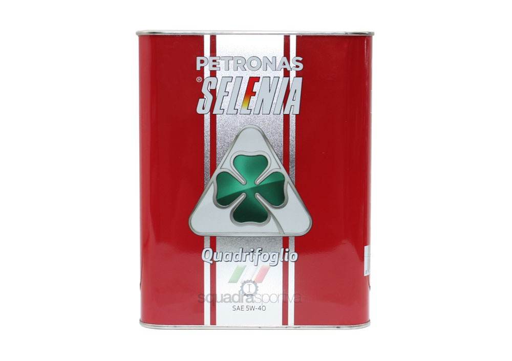

in alternativa va bene anche questo:
Technical data
SAE 5W-40, ACEA C3
Approvals: FIAT 9.55535-GH2 CONTRACTUAL TECHNICAL REFERENCE N°F022.B18
For the following engines / model series:
  • 1.8 TBi in Alfa 159, Brera, Spider 939, Giulietta and 4C
    necessary quantity for one oil service about 5,12 litres (159, Brera, Spider, Giulietta ) respectively about 5,8 litres (4C)
  • 2.9 V6 TB Quadrifoglio in various Alfa Giulia 952 and Stelvio (read the informations above!)
    necessary quantity for one oil service about 7,0 litres
Reazioni: TurBIzzato
