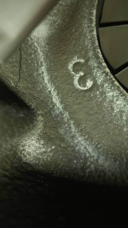

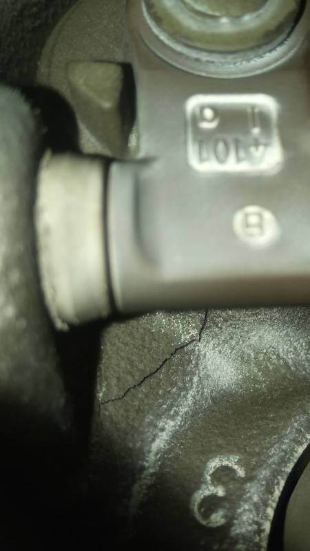

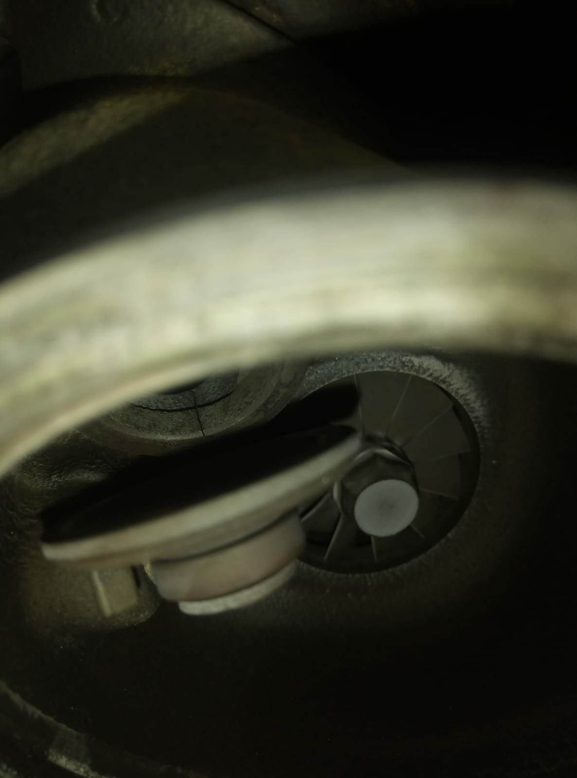

Il possible put a foto of cracking ? I want understand . I had the same problem . But in my case if fault of the temperature for the catalyst
Here are some photos:
It was cracked when I bought the car probably, because when tuned, the turbo could not give more then 1.5 - 1.6 bar of boost
I installed a DP a few thousand km after I bought the car. The design of the original catalyst is soooo bad.
How much boost is maximum safe for the 235 and 240 turbo?
The pressure is ok 1.6 1.5 for max boost but i fink you go thin of fuel . The turbo is perfectli cleen . And when you remap try to go a little bet fat of fuel .. and the turbo inevitably it is a bit dirty with soot . have you the control of temperature exaust ? It seems a break for temperature..
I agree with ZioDaedrico. Too lean mixture caused very high temperatures and broke the turbocharger.
Stock turbocharger can push 1.8 bar at mid rev and max 1.6 bar at high rev but you keep the EGT or at least the AFR.
At full load it must be max 11.6 - 11.8 for safety EGT (max. 980°).
