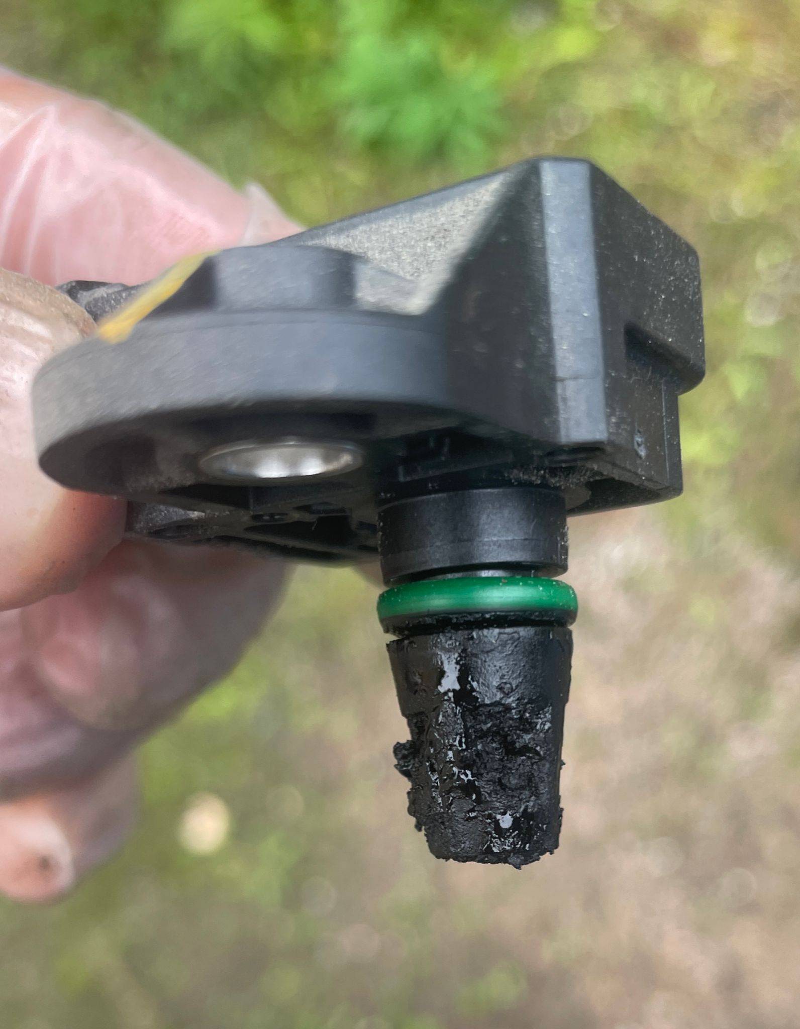

For the issue; I had P0100 code and started to lose power. Just like described in the original post, every time you ease off the gas the engine goes to limp mode. Restart and you have full power again. P0100 is actually a drift in MAF sensor value compared to MAP sensor value. Both sensors still show valid values but they just don't match. P0100 code links to MAF sensor but in reality, my issue was MAP sensor. I didn't replace any parts, just cleaned MAP from all the gunk (with MAF cleaner spray), gave it two days of driving and all errors went away. I believe if you replace the MAF sensor you also need to reset the values in the ECU to relearn the lambda values.
This is MAP before cleaning, I am amazed that it still showed values and no error code.
After cleaning I had errors P0100, P225C (Nox 1), P0101 (I disconnected the MAF sensor with the battery connected) and P2299 (brake and accelerator pressed simultaneously, no idea why). But given a couple of days after cleaning they went away.

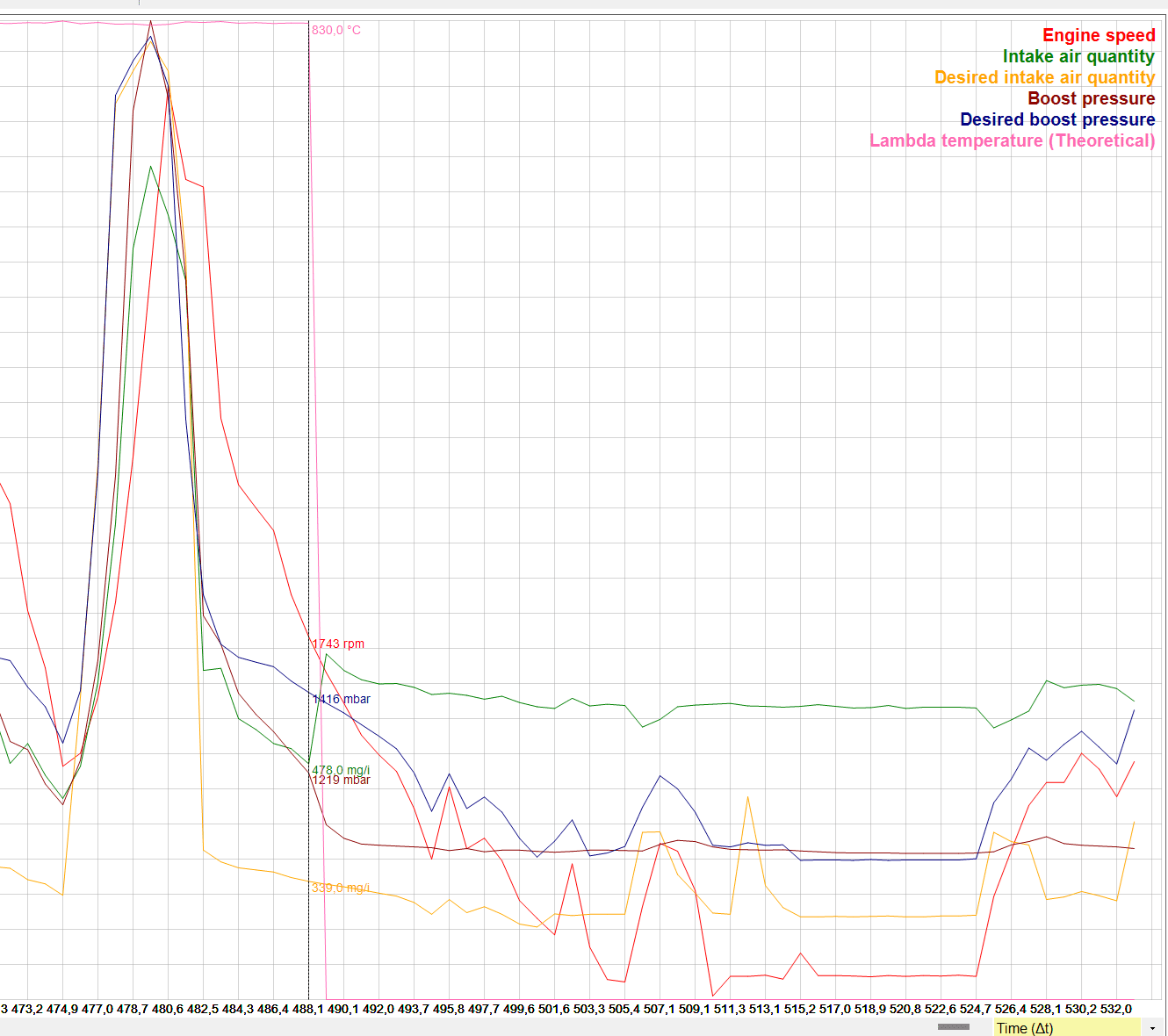

This is the fault in Multiecuscan, when easing off (coming to a ramp on a highway). MAF value goes up, but MAP does not -> Error. Vertical line is where to engine goes to limp mode.
Attached is also the recording from Multiecuscan if someone needs to compare their values. This is before cleaning!
