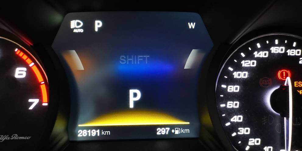

Shift will not work becuase in Q you have bigger rev limit. In q Gear change around 7000rpm,

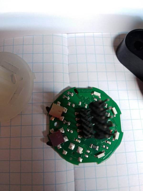

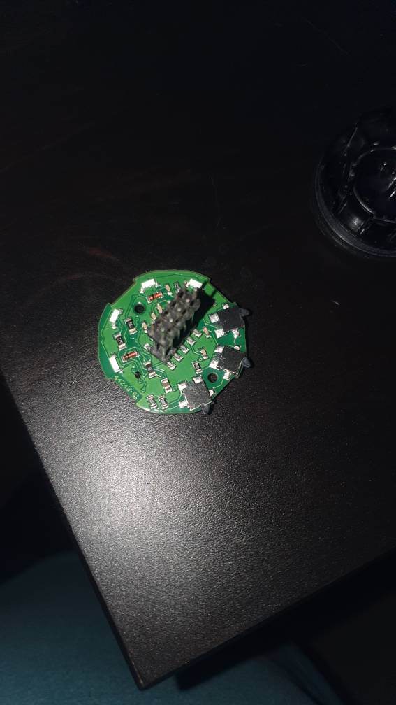

There is difference in dna gnob. I got 2016 and my gnob is the same as race, My collegue has 2018 and he has different gnob. So must change for original race to work.
“gnob” = “knob”
Is your colleague’s knob the one that returns automatically in N mode?
No. Stays at D N or A.
With 3 stick is good, with 2 you need to buy New one (knob with race)
What do you mean with "shift will not work". If shift dont work you can't use the car...
I'm very confused. Kozak seems to know the info but didn't tried it himself? Is someone trying to do what he said?
Would be nice to have all the info in the same post.

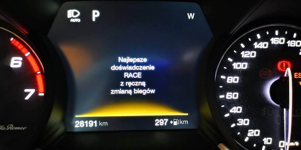

"shift" on the instrumental panel is not working!! Shifting Gear is working!!
Reactions: zampal90
I mean this "shift" is not working.
Have both cars (yours and your colleague's) got active suspensions?
Could it be that only the knob with suspension button can be updated to "race"?
Reactions: Paolo5167
No, la mia è Q2 ed il manettino non va bene.
Il codice sul componente che funziona è 28-16, mentre sul mio è 38-16, ha solo 2 pulsanti laterali invece dei 3 richiesti.
Devo ordinare il manettino... maledizione :D
