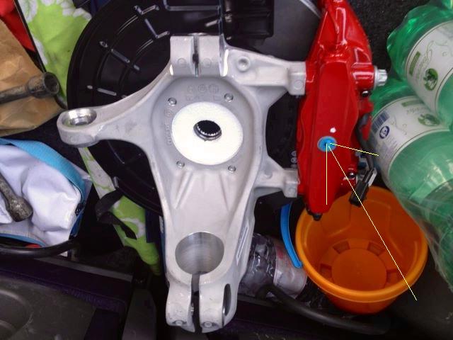

#219
Re: Giulietta Pinze freno rosse maggiorate
I'm not shure what do you mean by "4SU" option, but 'im pretty shure nobody here tried to mount Brembo calipers with 305 mm discs.
Just for a complete information, mounting calipers bracket have changed during these years.
Actual Giulietta solution require different knuckle (element number 13) with radial caliper fixing
102924
Previous Giulietta (and also Grande Punto Abarth) solution uses same brake caliper but knuckle fixing was made up using connection bracket like the one shown in photo
102792
If you do not want to change the knuckle the only solution is to mount Brembo caliper using connection bracket.
