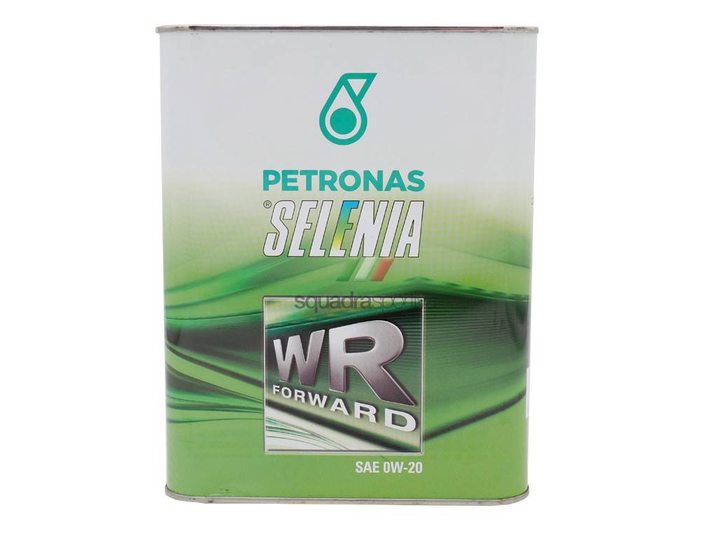

Prendo olio 5w-30 e (come da suggerimento del mio meccanico)
Ma per questi nuovi multijet 2.2 a gasolio, fiat non prescrive olio 0W20 oppure 0W30??
Selenia WR Forward 0W-20 is the new fully synthetic lubricant specifically designed for last generation diesel engines (Euro 6 standards)
and particularly for high-performance engines used in the luxury and sports cars segment.
The new Selenia WR Forward 0W-20 was developed with a low saps (low content of sulphated ash) formulation which allows:
  • high protection for the DPF system (Diesel Particulate Filter)
  • very high thermal stability
  • reduction of internal components frictions and this under every driving condition
A better protection of the engine during the oil-change interval is also guaranteed thanks to a high degree of shear strength.
The maintenance of engine performance is in this way guaranteed in short and long driving distances.
Technical data
SAE 0W-30, ACEA C2 Performance
Approvals: FIAT 9.55535-DSX,
Contractual Technical Reference N. F013.K15
Alfa Romeo's recommendation for the following engines / model series:
  • 1.6 JTDM EURO 6d temp (with AdBlue) in Alfa Giulietta
    necessary quantity for one oil service about 4,2 litres
  • 2.0 JTDM EURO 6d temp (with AdBlue) in Alfa Giulietta
  • 2.2 JTDM in Alfa Giulia 952 (136 to 190 bhp)
    necessary quantity for one oil service about 3,6 litres
  • 2.2 JTDM in Alfa Giulia 952 (180 bhp)
    necessary quantity for one oil service about 4,4 litres
  • 2.2 JTDM in Alfa Stelvio (from 136 to 190hp)

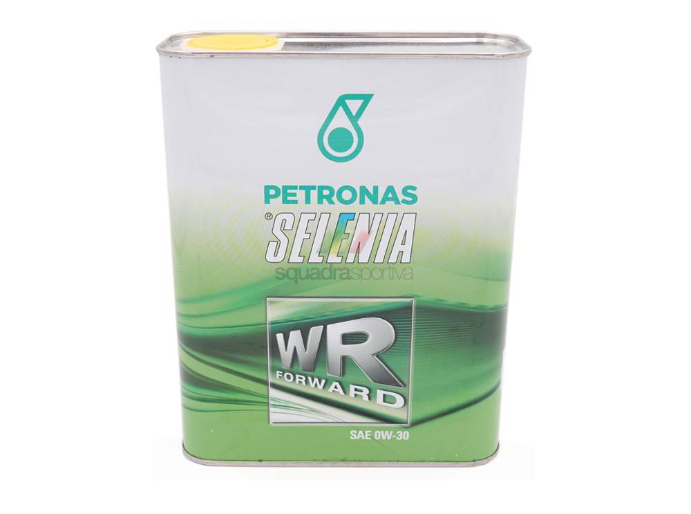

engine oil Selènia WR Forward 0W30
2 litres (70.38 fl.oz.) engine oil Selènia WR Forward 0W30
Selènia WR Forward is the new fully synthetic especially formulated for diesel engines already compliant with new Euro 6 standards.
Its particular viscosity grade permits to increase the fuel economy characteristics and consequently the reduction of CO2 produced.
Properties:
  • Maximizes fuel economy
  • Very high thermal stability
  • Total engine protection
  • It ensures compliance with anti pollution regulations
Technical data
SAE 0W-30, ACEA C2
Approvals: FIAT 9.55535-DS1
CONTRACTUAL TECHNICAL REFERENCE N°F842.F13
  • 1.3 JTDM in Alfa MiTo
    necessary quantity for one oil service about 3,9 litres
  • 1.6 JTDM in Alfa Giulietta
  • 2.0 JTDM in Alfa Giulietta
  • 2.2 JTDM Euro 6d temp (190 bhp) in Alfa Giulia
  • 2.2 JTDM (only 210 bhp) in Alfa Giulia Veloce and Stelvio
